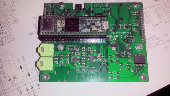

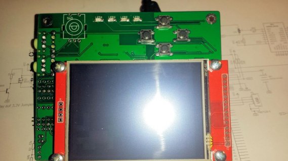

I got some of the boards below, if somebody wants one (for free), please email me. Invited are all from this beta-test-thread (including Paul ;-) ), but i can't send more than three - naked boards, unassembled, plus some parts (like PT8211, battery-holder, usb, ...)
It has PWM-Backlight, audio-out (+ active filter (c) by BEN), audio-in (schematic from the PJRC-site), LEDs+Keys via I2c-Extender, Nunchuck-connector, encoder, ir tx+rx, usb, 3x SPI-Memory, battery-holder, option to solder a esp12, an option for hw-debug (all optional), option to access all pads on the teensy-underside. 100mmx80mm.
Currently not all functions are tested. Things currently known to work are Display, PWM-Backlight, keys+leds, audio-out (incl. filter), Nunchuk. All other not tested.
Edit: 2 Boards left.
Edit: No free Boards left. If you want to buy one, feel free to ask :)
I got some of the boards below, if somebody want one (for free), please email me. invited are all from this beta-test-thread (including paul ;-) ), but i can't send more than three - naked boards, unassembled, plus some parts (like PT8211, usb, ...)
It has PWM-Backlight, audio-out (+ active filter (c) by BEN), audio-in (schematic from the PJRC-site), LEDs+Keys via I2c-Extender, Nunchuck-connector, encoder, ir tx+rx, usb, 3x SPI-Memory, battery-holder, option to solder a esp12, an option for hw-debug (all optional). 100mmx80mm.
Currently not all functions are tested. Things currently known to work are Display, PWM-Backlight, keys+leds, audio-out (incl. filter). All other not tested.
View attachment 9716View attachment 9717
Hi Frank — is there a schematic for the audio out filter?
