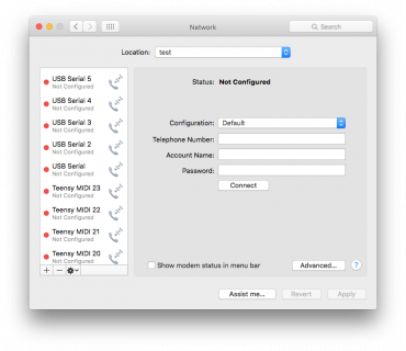

Yes, I think this is correct, what I noticed is when the USB Serial Port number increments, in the /dev/ directory usbmodem1073861 will never close. So if I unplug my Teensy that usb port number will still show up in /dev. Also in the System Preferences under Network you will notice that every time the usbmodem number increments it will show here as new Modem Type, I had hundreds of them.
What I did to fix this is to delete all "USB Serial" modem devices in System Preferences -> Network, then restart your computer with Teensy unplugged, once booted back up open Terminal and make sure no cu.usbmodem(x) is not defined then plug in your Teensy. Now the Teensy should be configured with the correct Serial Port name.

I did find a bunch of USB Serial and Teensy MIDI devices in the network control pane, which I deleted as @duff suggested.
I then rebooted and then tty.usbmodem401231 shows up properly and can be monitored and disconnected and reconnected again.
