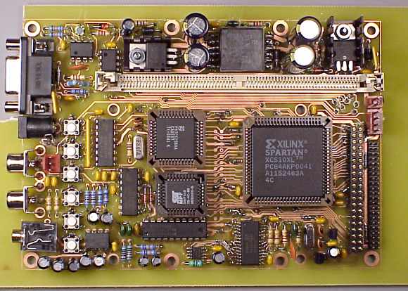

This MIDI drum machine in 1991 was one of the earlier boards.

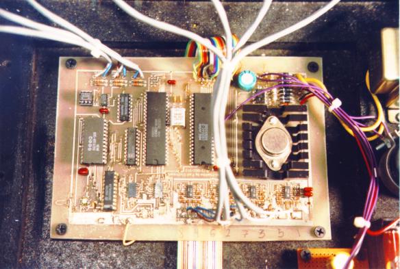

The old
MP3 player project (long before Apple made the iPod) is one of the last PCBs I made this way.
