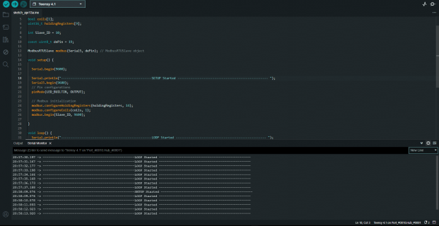

Hello,
I actually I want to Communicate my Teensy 4.1 with Modbus RS485 using MAX 485 Chip. I want this System to work as a Slave in my master network on MODBUS RS485/RTU.
So can any one help me with it like this is the code I am burning on my teensy device.
#include <ModbusRTUSlave.h>
// Modbus Configuration
bool coils[1];
uint16_t holdingRegisters[9];
int Slave_ID = 10;
const uint8_t dePin = 19;
ModbusRTUSlave modbus(Serial5, dePin); // ModbusRTUSlave object
  Serial.println("-------------------------------------------------SETUP Started ------------------------------------------------- ");
  Serial5.begin(9600);
  // Pin configurations
  pinMode(LED_BUILTIN, OUTPUT);
  // Modbus initialization
  modbus.configureHoldingRegisters(holdingRegisters, 14);
  modbus.configureCoils(coils, 1);
  modbus.begin(Slave_ID, 9600);
  Serial.println("-------------------------------------------------LOOP Started ------------------------------------------------- ");
  modbus.poll(); // Poll Modbus communication
    // Control LED based on coil value
    digitalWrite(LED_BUILTIN, coils[0] ? LOW : HIGH);
    // Update holding registers
    holdingRegisters[0] = 7;
    holdingRegisters[1] = 12;
    holdingRegisters[2] = 8;
    holdingRegisters[3] = 85;
    holdingRegisters[4] = 60;
    holdingRegisters[5] = 25;
    holdingRegisters[6] = 45;
    holdingRegisters[7] = 50;
    holdingRegisters[8] = 80;
  Serial.flush();
