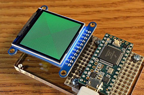

I'm testing the latest GFX now, with plans to include it in the next 1.46 beta.
I also picked up the Adafruit ST7789 display. Going to wire it up to a Teensy soon. No plans to buy or test the bare display from Aliexpress vendors.
Great! Any thoughts or plans to separate the Teensy bits to separate files so we can avoid the issue in the future? Ideally the latest Adafruit version would be included in the release and some way to get the versions with the Teensy speedups under a different name.

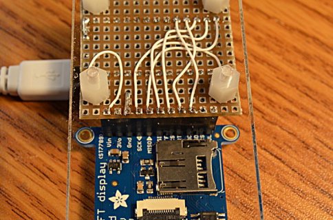

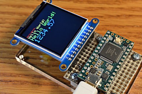

I tested Adafruit's 1.54 inch ST7789 display. It works fine with Teensy 3.2, when used with the latest Adafruit libs.
For this test, I deleted the old copies of Adafruit_GFX and Adafruit_ST7735 which Teensyduino installs into Arduino's hardware/teensy/avr/libraries folder. Then I copied the latest versions of those 2 libs from Adafruit's github repositories.
I ran the graphicstest example. I had to edit 2 lines, to use the Adafruit_ST7789 constructor, and the tft.init() for the 240 pixel display. Here's a complete copy of the exact code I ran.

As you can see from these photos, it's working perfectly.
I connected the wires as Adafruit recommends in their example code, to pins 8-13. Here's a photo of the bottom side, so you can see how I connected the pins.

I think it's confusing the way the pins are labeled on this display. I've been trying to connect this display with Teensy 3.6 but haven't had any luck. I'm sure I am mixing up the pin names (I'm a noob). I've been up since 3am so will try again tomorrow. A good night's sleep can make a huge difference. Thank you, Paul, for doing all the work that you do!
Agreed. The 2 letter names on the top side, and the abbreviated names on the bottom near the SD socket confused me too. I had to refer to Adafruit's page a few times while wiring this up.
But in the end, it follows the convention of most of Adafruit's products, where the pins wire up "directly" to Arduino Uno. Since we follow Uno's pinout conventions on Teensy 3.x, the same wiring works on Teensy... the first pin past the power goes to 13 on Teensy, then the next to pine 12, then pin 11, then 10, 9, and 8.

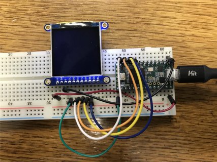

Revisitng this topic. Installed 1.46beta10. Deleted Adafruit_GFX and Adafruit_ST7735 from hardware/teensy/avr/libraries folder. Installed the latest Adafruit GFX lib (1.4.8) and S&7735 and ST7789 libraries (1.2.8). Ran Paul's code from #15
Result is a blank screen.
Difficult to see from this camera angle, but are the 4 wires to pins 9-12 shifted over by 1 place, so they're actually on pins 8-11 ??
EDIT: oh, I see now that the SO pin has no wire at all. I believe the display should work without that wire, but maybe add it just in case?
Also... and I know this is a longshot... check those 5 wires with an ohm meter. Many people have had troubles where one of those wires was bad. Frank recently had this on the T4 beta test with connecting an audio board. Really frustrating when a wire is bad.
Hi Paul - I really appreciate your help
So I tore it down, checked the jumpers for continuity and intermittents, added the SO line. No change - black display
I reinstalled 1.46beta10. Loaded the graphicstest example from the teensy directory, changed the defines of RST to 9 and DC to 8 and ran it. It runs but the offset into the graphics buffer is wrong (or right for the ST7735 but wrong for the ST7789). This is the issue that brought me to this thread. I understand that it is not the right driver but I think it shows the that the wiring and module are OK
Ughhh - retesting here and I also get the black screen issue. :(
Earlier I tested with version 1.2.4. Looks like something broke starting with version 1.2.6. I'm putting this library back on my list of issues to investigate.

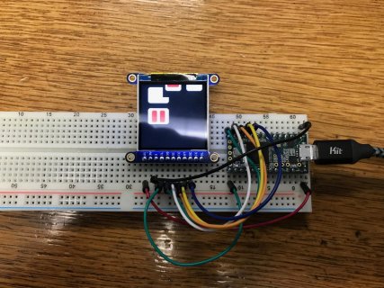

Here's how the buttons render at the end of "graphictest" with 1.2.5.
