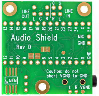

Hello,
After checking all connections and loading the Guitar example
I hear a little guitar sound but very drowned out by the noise. I will recheck the software installation. Is it possible that the hardware is faulty ? Either the Teensy card or the Audio card ?

If you are hearing some guitar sound while running the Synth Guitar example, odds are good the connection between Teensy and audio shield is correct. I do not know why it gives you bad sound. Maybe the audio shield is damaged? Or maybe the headphones are defective? Or maybe the plug from the headphones is not mating properly with the socket on the audio shield? Again, I do not know. All I can do is guess (based on the words you hear small guitar sound and large noise... I can not hear this by only these words).
Another possible problem (again, a blind guess) is if the headphone virtual ground (about 1.5V DC) is somehow connected to GND. Notice the words on the bottom side of the audio shield. Normally this is not a problem when only headphones are used, because the headphones do not connect to anything else.

Here the record file (I hope you can hear something). For the headphones both models work I tried on my laptop. "Notice the words on the bottom side of the audio shield". I don't understand what do you mean but I won't be able to look under the audio card anymore since I soldered it at the bottom with the test board like this :

I tried to listen to the "Voix 002.m4a" audio file. I can not hear any guitar sound. No indication the I2S data is causing even slight output.

I can check the signals : LRCLK (44.1 kHz), BCLK (1.41 or 2.82 MHz) and MCLK (11.29 MHz) with my oscilloscope. It's most likely a bad recording because when I put on the headphones I hear a lot of noise but you can make out the sound of the guitar a little.
Do you have a voltmeter? While the Guitar program is running, please try measuring DC voltage at several places. In all tests, connect the negative lead to Teensy GND. Connect it close to Teensy.
Measure these as DC voltage: (touch these places with the positive lead on the audio shield, not near Teensy)
Headphone L
Headphone R
LRCLK at audio shield
BCLK at audio shield
MCLK at audio shield
3.3V power at audio shield
Edit: on the headphone pins, approx 1.5V confirms the analog circuitry is active. On the 3 clocks, approx 1.65V confirms a 50% duty cycle waveform.

Yes I have a volmeter, I can do it but one question please with the volmeter you can see nothing with the signals :

On the 3 clocks, approx 1.65V confirms a 50% duty cycle waveform. If you measure close to 0 volts, the signal is not really connected.
You can also use the LED blink example to test any pin. Just edit the pin number and upload. Your voltmeter should see that 1 pin changing at the location on the audio shield, and all the others should not change (check if 2 pins are shorted together). Repeat for every pin.
During the connection testing, connect your voltmeter negative lead to GND near Teensy. Touch the positive lead to the solder on top of the pad on audio shield. The idea is to check whether each signal truly does connect all the way from Teensy (transmitting the slow LED blink) to the destination on the audio shield. If you touch the leads at other locations, you may be checking less than the full signal path from Teensy source to audio shield destination.

Test pin 7 first, since all 3 clocks have 1.65V and I2C previously worked. Pin 7 has the digital audio data from Teensy to audio shield.

Can you give me some time because I'm trying to redo the wiring properly by superimposing the 2 cards to reduce the noise. I look at PIN 7 with an oscilloscope probably ?

Finally, I don't need to do this test because now I can hear the sound of the guitar after taking care of the wiring a little better.
