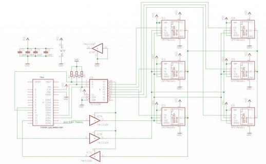

A little thing that I underestimated is that the buffer ( SN74HC367D ) prevents higher speeds . The maximum speed is only 6MHz(? without buffer and with 2 x 23LC1024 it was 20MHz) . Perhaps the layout plays a role too.
But I'm happy with it, it's good enough for my project.
(But let me ask, are there better tri-state buffers ? Ideally with inverted "enable" ?)
Try 74LCX126.
It has about 10X less propagation delay than 74HC367, and the tri-state control is active high, so you can avoid that extra inverter chip.
Likewise, you can get the 3:8 decoder as 74LCX138, for much less propagation delay.
If you make another board rev, please also consider adding pull-down resistors on Teensy pins 8, 16 and 17. Until you initialize those pins, they are high impedance. Resistors will keep those pins low, to prevent the decoder from accidentally asserting chip select to any of the memories.
It's also common practice to place a 0.1 uF (or even 10 nF) capacitor between 3.3V to GND near each chip. The length of the wires and especially the loop area between the wires and the capacitor and the chip matters much more than the actual value of the capacitor. One capacitor shared between 2 chips is usually fine, if the wires are short and run directly without a large loop.

Thank you!
I had tried to keep the component count low - my SMD soldering skills are not good (my eyes..).
I make a new rev. I'll swap top&bottom too, because I realized that it is not possible to add more memory later if the board is soldered under the teensy.

A Question, there is not much room for three additional resistors and a couple of capacitors.
I think it would be possible with 0603. I'm a bit nervous.. is 0603 manageable for SMD beginners like me?

The schematic looks good.
Yeah, 2 layers with parts on both sides creates a lot of challenges for routing the traces! But the electrons do not know or care about the difficulty in PCB routing! Still, having those capacitors close, even if the traces aren't ideal, is a lot better than no decoupling caps at all.
If you're planning on publishing these files for other people to build, I would recommend adding pin 1 marks in the silkscreen for all the chips. Without them, it's very easy to place a chip backwards! Rectangles around the resistors and capacitors are also helpful, to avoid a common mistake where 4 close pads (like R1 and R3) can be mistakenly placed with the parts on the wrong pairs.

I updated a few things including the slikscreen, and the vias are covered now.
Thank you!
C5 is unfortunately very close to the pins , but I can not do better.

I continued trying and finally I managed to accommodate the missing capacitors.
There was even room for an LED that is connected to the previously unused CS7 . Maybe it's quite handy . It is optional.
Paul, how much MCD has the teensy LED ?
So , now that was certainly the last version - For I have no desire to tinker it.

Minor comment - try running power lines such that they run through the positive end of the decoupling capacitor before they hit the local device that the capacitor is for. That allegedly helps keep the noise inside the device.
