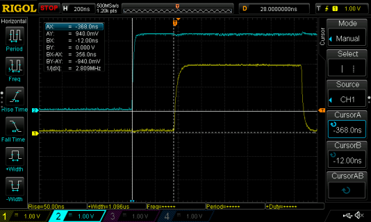

As a proof of concept, here is a sketch that uses an external 8mhz GNSS GPS pulse frequency as an external timer source to Teensy 4 GPT2 timer. In lieu of a pendulum PPS I used another GPS to provide a 1 Hz (PPS) to GPT2 capture pin. The sketch reports the number of 8mhz ticks between PPS ticks.

The GNSS GPS PPS with external antenna fires about 356 ns before the sparkfun gps

Powered up the 2nd GPS with reliable PPS.
Got the code working with the bouncy PPS that starts like this counting cycles between transition to HIGH in setup:
6151
1025
2337
Requires coding around that and taking the first _isr on pin RISING and having that _ISR do this to itself :: detachInterrupt(gpsPin); Then it has to be turned back on before next PPS pulse.
On the AdaFruit Ultimate GPS the PPS is clean and that same loop reads like this:
599997583
599997636
T:\tCode\TIME\Teensy_Cycle_CountingT4\Teensy_Cycle_CountingT4.ino Dec 18 2020 21:11:23
Proper PPS Found!
Then the code knows it has the 'Proper PPS'. And the same Sketch does BOTH given that detectable difference in setup().
Interesting thing is both GPS's seem to trigger the PPS at the same time!
Here are TWO T_4.0's with the two diff GPS units - with the code in a single sketch where::
>> 1st T_4 is the bouncy one - that a stable reading has been managed, then it drives a pin HIGH ( like the Pendulum swing detector will I suppose? ) It writes it LOW 600ms later at the same time it re Attaches the PPS interrupt detection.
>> 2nd T_4 in 'Proper PPS' mode has an easier time detecting the stable PPS with _isr, and also has a second _isr on the pin coming from 1st T_4
Those two signals seems to be splitting an I/0 BUS cycle as sometimes the 1st is first pushing it's PPS report by 26 CPU cycles and other times the 2nd gets it first by about 125 CPU cycles.
