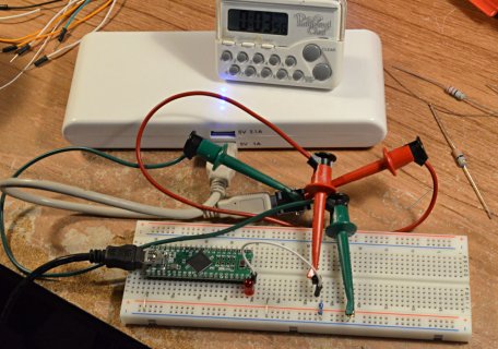

Just did a quick test. Mine shuts off in 13 seconds with no load. It's 19 seconds with a 27 ohm load. A 22 ohm load seems to keep it on. So far, it's been running for over 3 minutes.

Ok, I wired up a little NPN transistor circuit that puts a 230 mA load on the battery. I'm experimenting with a Teensy to pulse the transistor. With 8 ms pulses separated by 1 second, it ran for 45 seconds. Now I'm trying 9 ms and it's run for about 2 minutes so far... oh, looks like it just shut off about 2:20. Trying 10 ms pulses now....
Edit: 10 ms pulses ran only about 1:30. Trying 20 ms now...
Here's what I've got hookup up right now, just 3 parts, a red LED (approx 2V drop), a 2N2222 transistor, and a 10 ohm load.
When Teensy drives the pin high (to 5 volts), current flows through the LED (dropping about 2 volts) and base-emitter junction (dropping another 0.7V), for 2.3V on the 10 ohm resistor, for a load current of approx 230 mA. Of course, the transistor has high current gain, so if the load is providing 5V on the collector, most of that 230 mA flows from collector to emitter (the load on the battery). Only a tiny fraction flows from base to emitter. Pretty simple analog circuitry.
Edit: 25 ms pulse seem to be working very well.

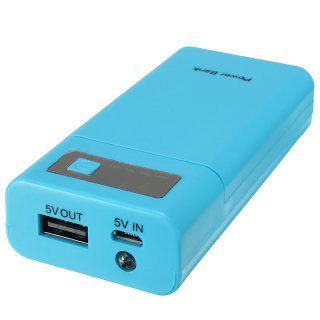

I recently ordered a very cheap powerbank case from aliexpress: Safety 5V 1A USB DIY Power Bank 2X 18650
I run into the issue described in this topic of the device switching off after a delay with low current. The proposed workarrounds did not help. I opened the device and found the IC used is a IP5305. This is a fully integrated power bank IC with a fixed switchoff-time of about 25s when the current is lower than about 45 mA. With an already running timer I created a PWM with a puls width of 200ms and a pause of about 6s to switch a BC639 PNP with a base resistor of 1k and a load resistor of 22R. That apparently does the trick with this bank.I did not optimize a lot, but shorter pulses, lower current or longer pauses did not work stable.
datasheet of IP3505:
http://www.injoinic.com/doc/pdf/IP5305%20datasheet%20v1.0_en.pdf
