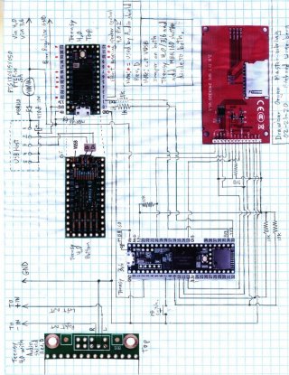

Here is the master wiring schematic.
IT uses a Teensy 4.0 attached to a Rev.D audio board and a Teensy 3.6 to handle the touch screen display and patch loading from the SD card.
They communicate with each other with a standard serial connections sending different parameters to each other.

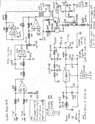

Here is the power supply and audio output section ect.
I am not sure how to rotate images when I post them.
I am using the stereo output of the audio board in a differential format with normal and inverted output.
This is to help cancel out any digital noise and helps make the noise floor lower.
The audio section also has a 7KHz low pass filter and is isolated with an output transformer.
The isolation is mostly only needed when it is connected to a computer thru the programming ports.

Hello, I just listened to the demo, and it sound nice !
There seem to be a lot of good ideas in your project for a real instrument like the inverted output, and many others that I don't quite understand as I am a newbie in electronics. How do manage to create inverted channels ?
Also are you using relay for controlling the MXR or some other elctronic trick ?
Would it be possible to see the code for this instrument ?
Thanks for your poject share.
Hi Regis,
in response to the inverted channels question, instead of running in stereo run signal thru two Amp objects using the audio design tool and set Amp1 to 1.0 and Amp2 to -1.0. this will invert the signal of the amp2 object. Then the left and right output is recombined using an op-amp. This technique is used in many commercial products and cancels out some of the noise generated in the digital to analog process.
I guess this is emulating a differential ADC to produce 6dB higher signal - it only adds benefit I think
if the bit depth exceeds the ENOB of the converters (which is often the case). Still its a useful trick to
remember - and you can use it to directly generate a balanced output signal too of course.
