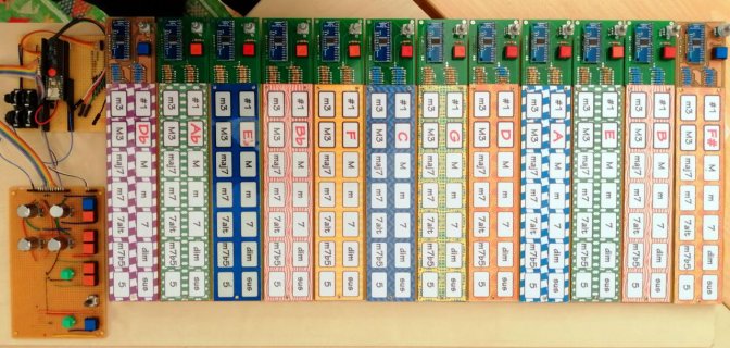

Here is a description of my chord player.
I am musician and composer. I play brass instruments and guitar. When composing, I often start with layering some chord progressions to find ideas. Since I don't play keyboards, it's difficult and frustrating. So I decided to build an MIDI instrument to help with playing complex and rich chord progressions. There are plenty of third-party plugins or devices, but they all have limitations : the choice of chords is poor, and a lot of them require to choose a «*root key*» which is a big constrain.
With the my prototype, you can play ready-made chords with one finger. With the right hand, you can play chords and with the left hand you can play a bass line. The choices of chords is large and goes from basic triads to complex jazz extended chords.
THE LAYOUT :
For each root note of the scale, there is a choice of 10 ready-made chords, plus 4 basses. The root notes are organized following the 5th cycle which is more logical when playing chord progressions. A pedal add an alternative choice of 10 chords. Here are the basic functionalities :
- a choice of 20 chord structures per note. From triads to altered chord, suspended, diminished, semi diminished... and "custom" chords.
- 4 basses per note. Root, Maj third, min third, b9.
- 168 force sensitives pads keyboard
- separate MIDI channel for basses and chords
- various knobs to control octaves, volume, chord inversions, velocity range, and a basic arpeggiator
- 12 pots + 12 switches (toggle or momentary) assigned to MIDI CC for controlling software.
- sustain pedal, pitch and mod wheel
- a bank to store "styles". The styles enhance some kinds of chord structure. For instance, the "jazz style" will emphase characteristic chord extensions to give a jazz flavor to the progression. Song writer style will emphase for instance the 9th with the major and minor chords...

To keep the budget low, I have made my own force sensitive pads. I have tested many assemblies and material. I have the best result with Velostat sheets. It is very cheap and easy to cut and glue. Here my "recipe" :
1 : PCB
2 : 1/10 millimeter plastic spacer
3 : Velostat
4 : printed plastic sheet
Result is quite OK. I have reliable and even response. Velostat is a delicate material. If you foil it or get it a bit dirty (finger prints), the readings are uneven.

I use 12 MUXs to read all the pads and knobs. I was worried about latency, but it is really fast. Absolute "real time" feeling. Code is simple, nothing new.
"mux_value[n]
" array stores pads readings. First index specifies the MUX number, second index specifies the channel number. "channel[][] " array stores channels adresses.
I know this could be simpler, but that was my first time dealing with MUXs...
