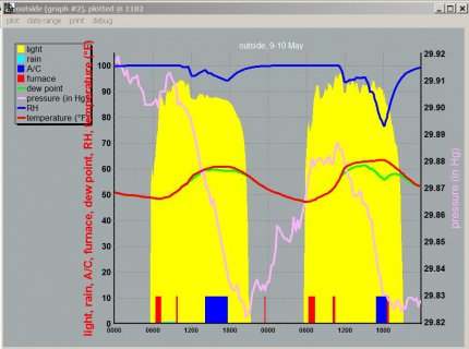

Several other forum members have described dataloggers for high-bandwidth datastreams, often status data from moving vehicles. I have completed a project that flexibly collects data from two or three dozen low-bandwidth sensors placed around my house, taking VC0706 pictures; measuring temperatures, pressures, water depth, power usage, and so on; and controlling relays.
The sensors are connected to peripheral stations, each built around a Teensy 3.5 and a real-time clock. The stations have identical hardware & software, but they can be configured through text files on the Teensies' uSD cards to work with different sensors and then either to use their XBee tranceivers to send the data to a central base station, or to timestamp & store received data locally.
The base station is built around another Teensy 3.5 and clock. It timestamps received data and then can store it locally for later transmission or transmit it immediately (through a USB connection) to a Windows program.
The Windows program is built around a relational database. Received data are stored in the database, and the database can be mined for graphs and statistics. Here's a sample graph:

This varies from sensor to sensor, but rarely as often as once a second. Remember, these are measurements of what is happening in & around an ordinary house. Why measure the temperature of a room every second? Why measure the temperature of a pond more often than every hour?
The reading/reporting distinction (Section 2.2.4.1 of my big document) is important here. For example, I look at my anemometer every minute, but I report an exponentially-damped running average only every 10 minutes. Also, as noted in Section 4.1 of the document, some data are recorded only when they change. For example, I have a photocell outside. It records a light level of zero for a few hours every day. The zeroes are duly passed in to the Base Station and then to the Windows program, but the Windows program is not silly enough to save all of them. In fact, it will save exactly four zeroes: first total darkness, daily signoff at 23:59:59, daily startup at 00:00:00, and just before first light.

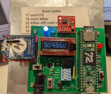

Do you have any photos of the real hardware, ideally in use? I see a diagram of the PCB on page 5, which is close, but to show this on the PJRC website, at least one photo or video of the real hardware is needed.
pictures

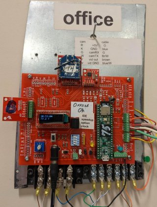

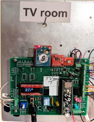

I'm sorry; I hadn't been aware of that rule. Here are pictures (in use) of the base station and two peripheral stations.base station.jpgTV room.jpgoffice.jpg The design is always evolving, so the "TV room" peripheral board is of a slightly different (newer) design than the "office" peripheral board.

(a) The old peripheral boards had too much sensor- and effector-specific stuff on them. For example, each of those boards reserved space for
  • two MID400 chips, so that the board could support detection of two different AC flows, and
  • a small relay.
In the redesign, the peripheral boards will have enough connectors to be prepared for any reasonable combination of my sensors & effectors, but the sensor-/effector-specific hardware (relays, debouncers, MID400s, and so on) will all be deported to daughter boards, to be deployed as needed.
(b) The CPUs on the various boards (then a Teensy 3.2 and multiple 3.5s; to be all 4.1s) were all socketed, so that they could be moved to a development environment for reprogramming. I am not using any of the Teensys' SMD pins, but the VUSB pins and the pins running crosswise (VBatt and so on) are not compatible with conventional socketing or breadboarding. Ad hoc socketing on my boards (to capture those abnormal pins) has made the Teensys difficult to pull out without damage. In the new version, each Teensy 4.1 will be soldered onto a breakout board bringing all of the pins of interest out to two conventional rows of breadboard-compatible pins. The breakout board will then be socketed onto one of my main boards. In every instance, this will mean loss of over a square inch of PCB real estate, but the increase in maintainability should be worth it.
(c) Some of the peripheral boards have to be in places where reading the TeensyViews is awkward for me (I'm not young). The new boards will have more LEDs, providing an information channel that under some circumstances has a higher effective bandwidth.
