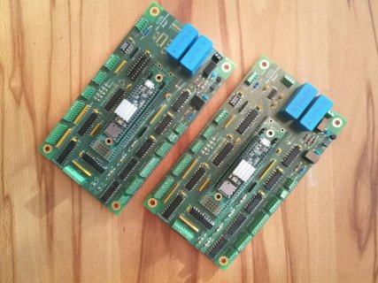

It runs on 2 teensies, communicating via a serial line: a T3.5 controls the cockpit and handles display, buttons, calculations etc., and a T3.6 in a separate control box does low level stuff such as generating motor pulses with TeensyStep. The machine controls the tension of the extremely thin winding wires with a pneumatic apparatus, so it also has to control air travel, pressure, valves, all fed by a small compressor.
I made a debouncing and deglitching library inspired by this article as I needed my buttons also to be deglitched: my library polls buttons and writes the readings into a history and interpretes the history by masking it, fast and reliable (can also process long presses, double clicks etc). The machine has 2 analog pedals connect to it which are managed by TeensyTimerTool.

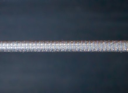

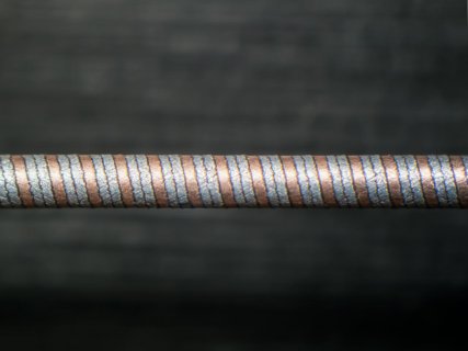

It's a very complicated project, it took me 2 years to built it, and still there are lot's of things to do. Here 2 examples of strings I made:
total string diameter 0.7mm, 2 alloys wound, wire thickness 0.12mm, ground to a metal layer of 0.06mm around the core
string wound with aluminium and copper wires, similar dimensions as above

PCBs designed in kicad (2 circuits on one board)
