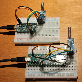

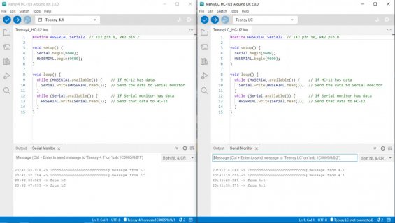

Purchased 2pc genuine HC-12 modules and hooked them up to a Teensy 4.1 and a Teensy LC.
They are communicating as expected, see this screendump using Arduino IDE 2.0:
Used Luca's code from message #5.
I was happily surprised that I could open a serial monitor for each Teensy at the same time - is this a new feature of IDE 2.0?
