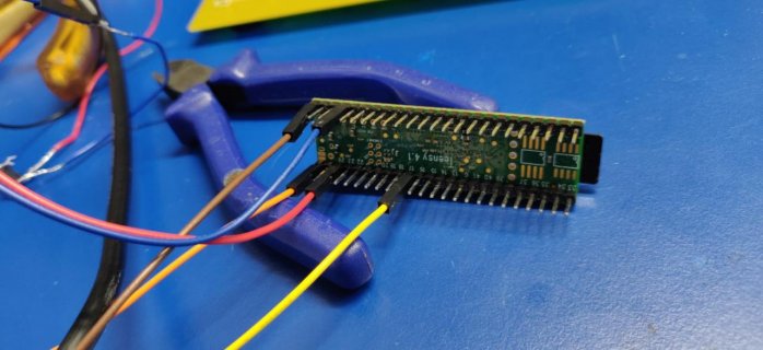

Hi everyone,
I’m trying to get a teensy 4.1 to be used as a datalogger in place of different, physically larger micro-controller. I’m testing it out, and it seems that the code side of things is ok (it’s recording samples at the correct rate and storing them to a card), but when I try to get a signal from a signal generator, I’m getting a lot of noise. I’m suspicious of there being some issue with whether I’m using the right ground pin, and if it’s treating some ADC channels as floating.
I’m currently using channels 14-25 to be used to collect 12 bit data with a sampling rate of 10 kHz. Data is being stored to a micro-SD card and it’s using a buffer to achieve the high sampling rate.
If you look on the picture below, the pins with X’s on them are the pins that are connected.
I’m powering the Teensy with a 5V power supply on a Vin and GND pin that is closes to the micro-USB connection. The connection between 3.3 V and pin 2 is just a button to get the datalogger to start recording. A signal generator is connected to pin 17 (and is connected to the GND pin I mentioned previously to get a common ground) and I’m doing a 100 Hz, 1V p2p, offset by 1V signal. When the signal generator is turned on, the signal read for pin 17 is correct, but several other channels have incorrect readings – showing a lot of noise. I don’t think this is due to the environment as I have run the same test on an oscilloscope and another microcontroller datalogger, and they show the data being absolutely fine. I think something is wrong with the GND, and it being as if the other pins are floating (or something like that). When no signal is coming from the signal generator, the signal is incorrect, it's not coming in at zero.

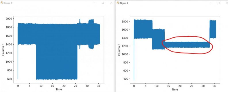

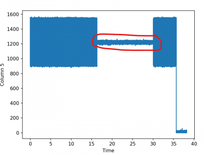

Sorry if I'm just misunderstanding you, but I thought my input wasn't floating (in the bit that is circled in red). There it is connected to a signal generator that is turned on at a fixed offset voltage, and the signal generator shares a common ground with the GND pin of the teensy. As far as I can tell (I might be missing something), I'm following your advice here:
When the signal generator is off you have a floating input I think - don't do that, just turn the signal generator amplitude down to zero.
but I'm still getting lots of noise. see the red bit on this graph - then the signal generator is on so I don't think it's floating:

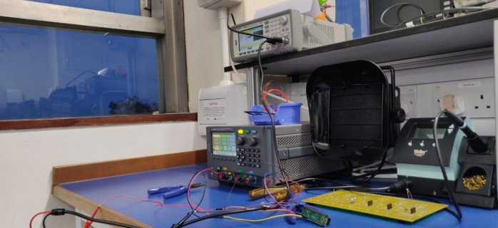

Which signal generator are you using? Perhaps a photo of the setup?
here is a picture of the setup:
Here is the waveform generator I'm using (a keysight 33500B - a pretty expensive one):
Here is the voltage source:
Here is the Teensy (when using 1 GND pin):
I've tried using the waveform generator on an oscilloscope and another microcontroller that does data logging, and have not received anywhere near the same amount of noise.

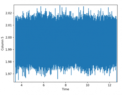

How much noise do you see if you add a capacitor between the analog pin and ground (say 100nF or so) ?
I tried this, and it didn't really seem to make a difference (I also had a resistor connected).

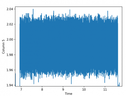

You may have a ground loop. You probably have an SD card that draws quite some current when writing. And you maybe use a power supply that is dipping when the Teensy draws more significant current.
I think the reference voltage for the ADC is the 3V3 rail. Is that a steady 3.30 V or does it have ripple order of magnitude of what you see as ADC values noise?
On ground loop: draw a schematic and add say 1 ohm series resistor in your brown GND wire. You will then see that when the power supply current rises by say 50 mA that your Teensy pin 1 GND level rises 50 mV above what you assumed was 0. And then your ADC reports 50 mV ’error’.
Tests to do:
* wire a 1.5V battery to your Teensy ADC input pin (+) and to Teensy GND (-) directly, but don’t let the same wires carry power supply current. Do you then still see these weird excursions?
* better/other 5v power supply.
* no SD card, but write to Teensy RAM or flash disk instead.
Better would be to use ADC in differential input mode.

Unclear from what’s posted is what triggers ADC sampling and conversion (a timer interrupt so that it’s deterministic?), what upstream analog anti-alias filter you use, as in order and cutoff frequencies, what (if any at all) oversampling you have in the Teensy, and what the source output impedance of the analog voltage signal is.
Just to make sure, are you in agreement that the issue that we are looking at is the noise level, not the change in voltage when I plug/unplug a voltage source/signal generator. i.e. the bit circled in red:
I did experiments 1 and 2. In both cases the noise level remained:
experiment 1 (I used a different GND terminal to connect the GND of the 1.5 V battery):
Experiment 2 (I used a power bank, as opposed to the cleaner and more expensive voltage supply, noise levels looked about the same):
the data shown is pre-filtering. I can filter away some noise, but it looks pretty uniformly distributed across the FFTs, so getting rid of more of it here would be helpful.
