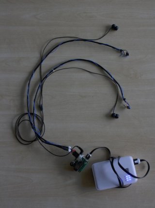

Top view on wearable experimental configuration of:
- teensy
- audio shield
- special ICS-43432 microphone pcbs
- custom black-blue audio data cable
- headphones
- usb-battery
This picture shows a close up for size comparison:
