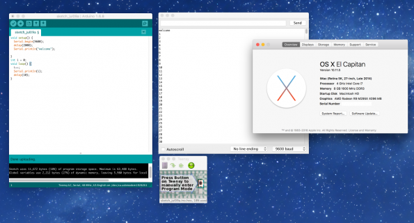

I tested this today on an iMac running El Capitan 10.11.5, running the sketch in msg #1 and viewing with the Arduino Serial Monitor.
I was unable to reproduce the problem. Here's a screenshot:
Edit: just to be clear, I uploaded several times. Every attempt showed the same results in the serial monitor. I never saw even once a missing number. Each time, I looked only at the first 30 numbers (auto-scroll disabled).

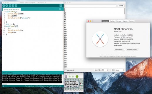

first time upload just worked, the second time i uploaded it missed numbers:
is there something i can try?
some changes in the code to get some details about the problem?
