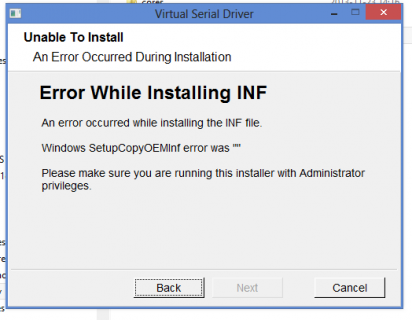

Hi
I had to start from scratch with all my dev stuff as I had my laptop liberated. Now I am having all kinds of issues that was never a problem before.
My USB Serial port is not recognized when I plug my Teensy3.0 in. I then tried to oload the drivers with the serial_install program but that gives the attached error. All the other serial configs work with the Teensy3.0, just the USB Serial is broken.
Oh and I am using Windows 8.0 now :(
Correct. It only allows unsigned driver install for that 1 boot. As soon as you reboot normally, you're back to the normal settings that don't permit unsigned driver install.
OK that sorted it out. Now the question is why did I loose it in the first place? Did I do something stupid somewhere?
