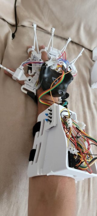

We were using a bno050 on a t32 to control an emulated mouse but we have issues with the low polling rate due to bno055 and radio delays.
The hope /idea was to test with the bno080, but we have been running in all sort of issues even before being able to test the polling rate of the emulated mouse using the bno080
We have been working on emulating mouse and joystick for adding head movements in certain games.
We have been working also on hand controllers using exoskeleton for both VR gaming and regular gaming.
We use teensy boards
https://www.youtube.com/watch?v=DYrK1zF27YU
Would be very grateful getting help please

Thanks for your input on this matter. I'm working with him on this project.
The issue remains now is that when we power up the teensy bno080 is not detected sometimes. Turning on/off couple of times and it detect.
