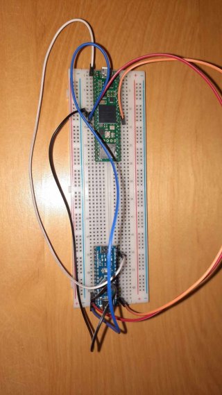

So i have been trying to make SPI communication between nano and teensy when nano is master and teensy is slave but its not working i also tried multiple codes and such. I also tried SPI_MSTransfer_T4 library but with no luck. I tried to use code where arduino uno was communicating with another uno but i got error on line with this line : ISR (SPI_STC_vect) // SPI interrupt routine
I´ll be glad for any suggestion.
Thank you

I want to help more, but I really can't. With technical questions, there are really 3 levels.
#1 - Best case is enough information to reproduce the problem.
#2 - Not as good but still possible to answer is when enough info is given to at least see the problem and the steps performed to cause the problem
#3 - Little to no info beyond "doesn't work" pretty much means any help amounts to blind guessing
I hope you will consider showing us photos of how you connected the hardware, clear info with links to the code if you used examples without modification or exact copies of the code if you changed anything (for the code used on both boards), and screenshots or exact copies of whatever error message or other wrong behavior your eyes actually observed. Please, don't just say it didn't work. Show us what you actually tried and allow us to see with our own eyes the wrong result. Or best of all, give enough info so anyone with those boards could quickly wire them together exactly the same way you did and actually reproduce the exact same problem.
well i certainly can provide you with wiring, and for the code the one i send was the first one but like i wrote i also used the SPI_MSTransfer_T4.h but with this error it went throught and was uploaded. This was the error:
