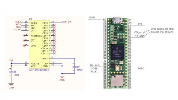

Hello everyone,
Summary
I am trying to use a Teensy 4.1 to talk over SPI to an AD7147 (a capacitive-to-digital converter (CDC)). However, the connection is inconsistent: the system will fluctuate between receiving the expected data and receiving 0s.
Setup
  • My setup is a Teensy 4.1 on a breadboard, with the AD7147 sitting on a separate test PCB that I made. The separate test PCB also has 2 other devices on the same SPI bus and communication with these devices is working.
  • The breadboard and test PCB are connected with jumper wires. The wires are no more than ~6 inches long.
  • I'm using Teensyduino 1.59.0, Arduino IDE version 2.3.2, Ubuntu 22.04
  • A picture of my setup is shown below
Minimal example and behavior
I am using a short test script (shown below) that simply tries to read the device address from the AD7147. The expected behavior is the AD7147 will return its device address and this will be printed on the Serial monitor.
The behavior I see is that sometimes the correct device address is printed and sometimes 0 is printed. Pushing the ground wire around will sometimes (not always) change whether it’s working or not working. There are a few things that I’ve found cause the device address to be returned consistently:
  • If I disconnect the Teensy ground from the test board ground (i.e. the AD7147 is no longer grounded), the correct device address is returned continuously
  • If I probe the chip_select line with the oscilloscope probe, the correct device address is returned continuously
  • When I unplug the chip_select line, the correct device address is consistently returned a single time
Here are a few other notes:
  • Using certain digital pins on the Teensy for the chip_select seem to affect the behavior. For example, I’ve found that using pin 25 does not work most of the time, whereas using pins 7 and 8 work most of the time.
  • I am using 10k pullup resistors on all chip selects
  • I have confirmed that all of my devices have correct tri-state behavior on MISO (https://www.pjrc.com/better-spi-bus-design-in-3-steps/)
  • I’ve looked at all the signals on an oscilloscope. Everything looks correct, but it is difficult to look at the signals when the system is NOT working because as I said above, probing the chip_select seems to make things work.
Based on this behavior, my suspicion is that my chip_select sometimes does not get pulled LOW, perhaps due to some problem with my grounds? Does anyone have thoughts on what may be going on or suggestions for how to debug further?

Your SPI bus wires should be tightly bundled in parallel with at least one ground wire, you have a lot of stray inductance with the rats' nest wires, and they act as magnetic antennas to stray RF...
Use much shorter wires (I cut wires from single-core hook-up wire so they can be short and direct).

What is the orange wire supposed to be connecting?
It's a 5V line used for a another device. It's not used for the AD7147.

Maybe try with the default SPI1 pins? Just move the MISO wire from pin 39 to pin 1, and delete these 3 lines.

intermittent SPI operation, especially when it is affected by putting a scope probe or finger on it (adding a small capacitance), usually indicates a signal quality issue related to wiring layout from my experience. Either ringing on the lines, cross-talk or signal skew between the lines affecting setup and hold times. As a side note, using the x10 mode on the scope probe introduces less capacitance than using x1, so tends to affect circuits less.
Besides the suggestions already made, with your current setup you could try adding small 50-100 ohm resistors in series with the MOSI and CLK lines near the Teensy 4.1 to help dampen any signal ringing that may be going on from the wiring and that also helps cross-talk by slowing the edge transitions a bit. Maybe throw one on the CS line for good measure. Even with good wiring layout, I now use series resistors on any SPI bus that runs any distance as a preventative measure.
Adding series resistors solved the problem! On an oscilloscope, I can see a lot of ringing that is cleaned up by the series resistor. Using a resistor as low as 33 Ohms cleaned up the signal a lot and made the connectivity consistent. I had to go up to 100 Ohms to get a pretty clean CLK signal, and using a twisted cable helped with this as well. (I was still able to run at 20 MHz with 100 Ohm resistor)
Thank you everyone! This is super helpful since our actual application has long (~1 foot) wires between the teensy and the device, so this will be important to keep in mind.

I tried this and it did not seem to make a difference.
