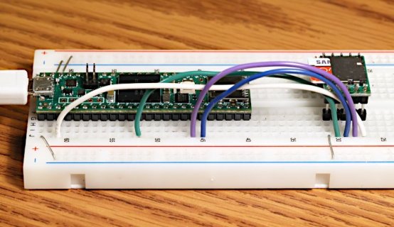

@PaulStoffregen Thank you for your answer. I just can't figure this, I followed the same schema as yours and I used the exact same code, but it just doesn't work. I use the arduino default microsd card adapter. If anyone has any idea of what could be going wrong, I would be graceful. Thanks.
(by the way your library sdfat is just insane : )
That looks like one of the problematic SD card adapters. Many people have experienced problems with those.
Power is the first issue. Hopefully you can find good documentation about the its power requirements. But often these are made by Asian companies who give little or no info, or they copy some other design but sometimes substitute cheaper parts. Ask the seller where you bought it for info. The main thing you need to know is whether it is meant to be powered by 3.3V as you've wired in this photo, or if it has a 3.3V regulator on-board and if so, what input voltage does it need. Some with regulators claim to accept a wide range, but cheap copies have different voltage regulator chips that basically need 5 volts to properly create 3.3V for the SD card. If you have one of those models and you attempt to power with 3.3V, the SD card ends up getting about 2 volts and can't work properly.
The other common problem is slow buffer chips. I believe we reduced the default SPI clock to only 16 MHz in recent versions, so this shouldn't be as much of a problem as it was when we had 24 MHz as the default. But some of the really cheap models are only able to work at the 8 MHz speed used on 8 bit Arduino. We have a way to control the SPI clock speed. In Arduino, click File > Examples > SD > SdFat_Usage for the special begin() functions that give you more control over SPI settings.
While you're trying to just get the hardware working at all, I'd recommend wiring it up to the main SPI port (pins 10, 11, 12, 13). Then it should work with the normal examples. You can always just move the 4 signal wires later, after you've made it work on the main SPI port.
@PaulStoffregen Thank you very much now it's working. I changed the microsd card adapter as you suggested and it's fine. I use a code that you provided in an example and I modified it a bit. But your code is meant for controlling the sd card slot that is built in in the teensy 4.1. It's quite hard to understand the parameters that I have to change on top of the program to make it work for my external microsd slot. Could you help me ? Thank you.

I tested this just now on a Teensy 4.1 with SD card connected to SPI1 (but using pin 10 for CS). It definitely does work.
I've updated the SdFat_Usage example to show how to use SPI1.
https://github.com/PaulStoffregen/SD/commit/9912b57a0fa05de883ae8a0953386cbaf054b37b
To move CS1 from pin 0 to 38 -> change chipSelect
To move MISO1 from pin 1 to 39 -> add : SPI1.setMISO(39);
   while (!Serial); // wait for Arduino Serial Monitor
   bool ok;
   const int chipSelect = 38; // 10
   SPI1.setMISO(39); // <- added
   // Different SPI port (Teensy 4.1 SPI1 is MOSI:pin26, MISO:pin1, SCL:pin27)
   ok = SD.sdfs.begin(SdSpiConfig(chipSelect, SHARED_SPI, SD_SCK_MHZ(16), &SPI1));
   if (!ok)
     return;
