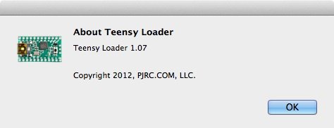

I also have this very weird problem. I have downloaded teensyduino from here (http://www.pjrc.com/teensy/td_download.html)
But when I check the version, its showing up as Teensy Loader 1.07.
fatal error: arm_math.h: No such file or directory
You'll need to copy that .h file and any others it needs. The simplest approach would be to just put them into your program's folder.
That's normal. Originally the Teensy Loader was developed separately from Teensyduino, so it has its own independent version number.
I'm considering just bumping it up to 1.15 and keeping it in sync with Teensyduino, which ought to be less confusing?
