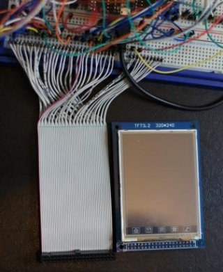

I used the UTFT/ARM 320x240 demo, and only changed the myGLCD part of the sketch because when I compile, it already says "using pins 0-15". Power is constantly on through the USB cable. Still just backlight with unlit flashes at times. Does that mean it's probably not an SSD1289?
Where did you get it, can you send a link? Can you post a picture, front and back? Does the PCB silk screen have a pin out on it?
We will get you there, I know how frustrating it is to have a new toy and not be able to get it working! :0)

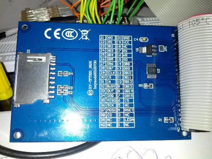

Front:
Back:

The pin configuration in the ebay ad confused me for a second, but the columns are just switched because it's looking at the board from the screen side. The numbers are all different, but the pin labeled LEDA is lighting up the backlight so the board's listing should be right.

i'm honestly at a loss as to what to suggest. About the only things that come to mine is to try the library I posted earlier in the thread.. It SHOULD be the same as the one dawnmist posted, except that its just hard coded for pins 0-15 without using defines. And also, to double or triple check your wiring, especially the ones defined in library init in the sketch, and make sure RD is attached to 3.3v
Actually one thing that does jump out at me is make sure you're using the right CS pin. There are 3 listed in the pinout on your LCD.. one is for the touch screen, one is for the SD card reader, one is for the LCD.. going back to your ebay listing you linked in the pipgirl thread, the pin 6 one seems to be the one that goes to the LCD. Though the numbers are reversed from those listed on your ebay auction.
I'm betting this is just a wiring problem now actually.
Hrm. I did plug in that right CS pin, and RD is connected straight to 3.3V and still nothing. I've checked and rechecked the init pins and data connections (though would switched data lines keep any image from showing up or just scramble the image?).
I feel like it's either something stupid, or the lcd board is fried. The LED on the teensy lights up like pin 13 is receiving a signal, but nothing ever shows up on the lcd. It doesn't even flicker anymore. I guess if all else fails, I can use the lcd as a backlight for my project.
The only other thing I can think of is that the IDE cable that I'm using to bring all 20 pins out so I can use jumper wires is messed up.
Thank you again for your help.

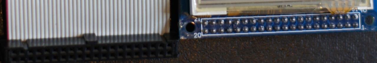

To clarify here are some pictures:
When the screen is plugged in it covers the ribbon. The left most core of the ribbon is pin 21 which is the red core. If you go by the info on ebay the next core is pin 1; if you go by the silk screen on the PCB it is pin 20.
Following the ebay numbering then my connections to the bread board are from left to right 1-40, going by the silk screen they are 20-1 then 21-40.
If you use the ebay numbering to make things easy, pins 1-40 left to right in the picture above on the right, the connections would be:

ie Pin 20 on the silk screen is shown as pin 1 on ebay, and so on:
Silk Ebay
20 1
19 2
2 19
1 20
Pins 21-40 are the same on both the silk screen and ebay making the ebay details easier to follow when you get to playing with the touch.

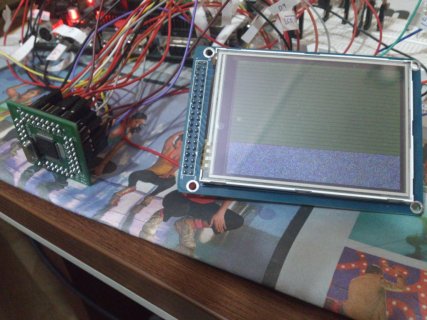

I too was having the same problem that Qumefox had when he first posted
I've interfaced this LCD to an LPC2148.

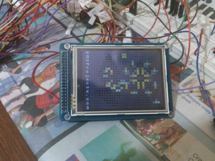

Managed to find out the problem. At first, I thought 2 jumpers were shorting, or that I had mistakenly swapped data lines. These are of course the first things you should check, and that is what i did, still no go.
I used a USB-based digital scope to check EACH and every line ONE at a time, turns out that one of the data lines wasn't pulsing from peak to peak since there was a capacitor across it !! A saw-wave was being output at this data line.
