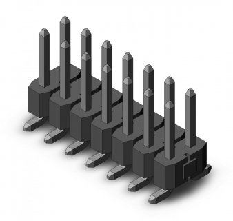

I'd love to hear a recommendation regarding designing a PCB for drop-in Teensy 3.0 support that includes the pin-pads on the bottom.
Is there some special part that can be found to elegantly bridge the gap between those pads and the custom board, either to be soldered onto the Teensy beforehand, or pre-mounted on the new PCB?
Thanks in advance. Looking forward to more info regarding the MINI54 product. -Dan
Edit: Looks like Samtec TSM-107-01-T-DV might work. Think so?
Trying some Samtec TSM-107-01-T-DV on Teensy3 bottom pads
Am ordering some of these today. Will let you know how they work out.

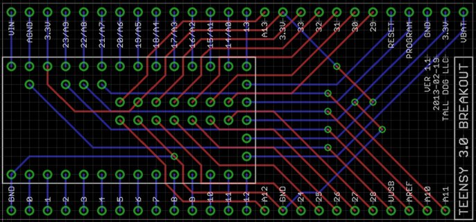

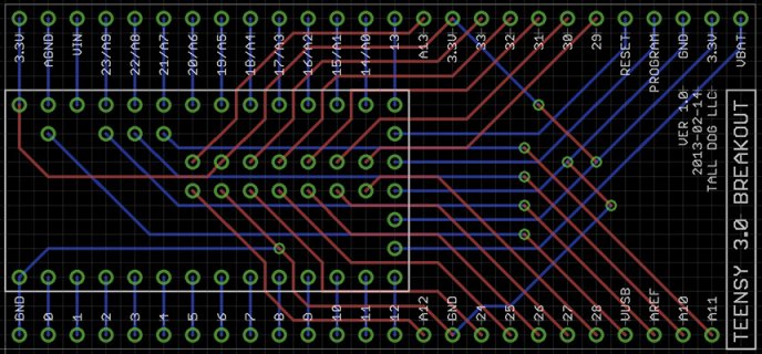

Since I've been breadboarding with the Teensy 3.0 and using a bunch of the bottom pins, I decided to try and build a breakout board for it. Also, this serves as kind of a test for mounting a Teensy 3.0 on a custom PCB in general, since I know I'll be doing this more in the future. Anyway, an image of the design is attached, and it breaks out all of the available pins to two rows that are spaced to fit well on two side-by-side (interlocked) breadboards. This also assumes use of the part listed above (Samtec TSM-107-01-T-DV) for the bottom pins.
Please let me know if you have any comments or pointers or suggestions or anything else. -Dan

I received mine, and they work great. Easy to solder and the alignment is perfect. It's much easier (aka basically necessary) to solder the underside header first, before the pin headers along the sides of the Teensy. In fact, I had to desolder and replace the side-pins on one Teensy in order to attach the underside pins, since my soldering iron wasn't narrow enough. -Dan

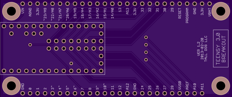

Consider adding mounting holes
If I may make a tiny suggestion -- if possible have some M3 sized holes for mounting the pcb with standoffs, or for securing on wood, MDF, etc. platforms.:cool:
I don't know if it is possible to have indication of the pwm pins, touch sensor, and serial ports. I suspect you can only do so much and have it still be readable.
FWIW, just be aware that the descriptions for the 3.3V pin and the VIN pin at the top left of your board are swapped. This could lead to a bad day (i.e. burned-up Teensy 3.0).
The (left to right) top pin sequence should be VIN, AGND, 3.3V, 23, etc. not 3.3V, AGND, VIN, 23, etc. as indicated by your silkscreen. See the Teensy 3.0 pinout diagram attached here for further details.
HTH (and recovering from a semi-heart attack thinking I had gotten my PCB wrong!) :)
Good catch! Thanks. Gonna see about fixing that now.
I debated this, but ended up not including them because they would add a fair amount of size to the board. Likewise with the pin indicators you mentioned.
I'm gonna play around with an alternate design that incorporates some of these elements.

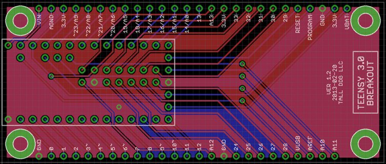

Revised PCB design.
Includes holes (0.12" for #4 screws) and PWM markers (~).
Cost is up to $12 from a little under $8 due to the size increase.
What do you think?
