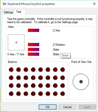

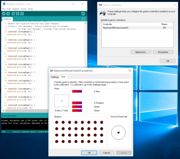

I am completely new to teensy and arduino so please excuse any of my mistakes. Anyway im trying use my teensy 3.1 as a joystick, i currently have 2 buttons connected to it(starting out simple) and im using the microsoft game properties to test it. The problem is when i press one of the buttons it shows the button working but it also changes all of the axis controls and the hat control. I am Running windows 10. I have the pictures of the before and after attached.

Any chance you could try on a pre-10 version of Windows?
I just got my copy of 10 today... haven't installed it yet. Will do soon.
I just tried it on windows 8.1 (Had my laptop near me) and unfortunately it does the same thing
Ok, I've managed to reproduce the problem you're seeing on Windows 10. Well, at least I think I've got the same thing here.
After programming Teensy and opening JOY.CPL, I see this:
(click for full size)
Then, as soon as I press a button, the X-Y position and 4 axes go to zero, as well as the button indicates pressed.
This may seem as if something is wrong on Teensy, causing the buttons to interfere with the axes. However, there is actually nothing wrong on the Teensy side.
The problem is Windows 10 is just making up default data before it receives any communication from Teensy. Before that first button press, Windows has never received any info from Teensy, so it has absolutely no idea what the X, Y, Z, Zr and Slider position are. It's just defaulting to showing them at the center of their range.
If you never set those parameters, Teensy defaults to zero (on a scale of 0 to 1023). Perhaps Teensy should instead default to 512? Obviously Windows is assuming the default is 512, before it gets any real info.
Anyway, if you want the Windows joystick control panel to respond the way you expect, all you need to do is add a little code inside setup(), like this:
    Joystick.Z(512);  // same as Windows default
I am so glad you able to reproduce it, for a little bit i thought i was going crazy lol. Your solution works perfectly, thank you so much paul for your help.

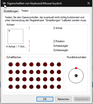

With that code, i have the same problem again.
After press the first button, you see that.

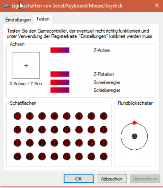

first, try this:
Joystick.Z(512);
Joystick.X(512);
Joystick.Y(512);
Joystick.Zrotate(512);
Joystick.sliderLeft(512);
Joystick.sliderRight(512);
//Joystick.slider(512);
.. this uses the Windows defaults for the other values, too
To see the change, click on "Auf Standard zurücksetzen"

After that, all buttons in the middle or off, but if you click one time, the + are upper left and the round-button are up.
I want only buttons on my teensyLC.
Nö,bei mir nicht. Hast auf "Auf Standard zurücksetzen" geklickt? Hast du das neue Programm überhaupt auf den Teensy übertragen?
something is wrong.. perhaps sleep a night and try it again. :)
sorry, I don't know what the problem is now. Ausserdem läuft dr who im TV.
sorry to necro this thread but I noticed the hat is showing a forward activation. Why is that? I ask because I am having the same oddity and it is causing my tactical analysis flight appplication (tacview) to continually scroll left unless I disconnect the teensy.
