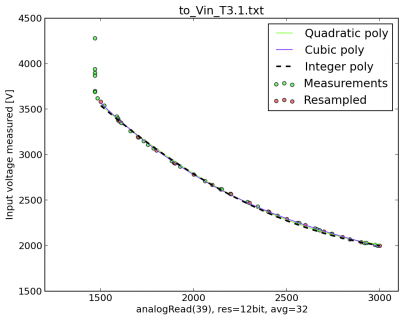

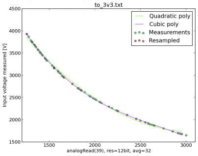

Input to 3v3 pin:
The polynomial coefficients found are: (leftmost is x^2 and x^3 respectively)
Coefficients P_2: [ 6.24435071e-04 -3.86562880e+00 7.70557029e+03]
Coefficients P_3: [ -3.43172539e-07 2.78848110e-03 -8.24887282e+00 1.05447294e+04]
Input to Vin pin:
Coefficients P_2: [ 4.79305738e-04 -3.18084349e+00 7.22111948e+03]
Coefficients P_3: [ -2.31118140e-07 2.03935318e-03 -6.60300979e+00 9.65583352e+03]

This integer representation of the polynomial is also plotted in the graph, where it can be seen that this hardly deviates from the floating point values.
