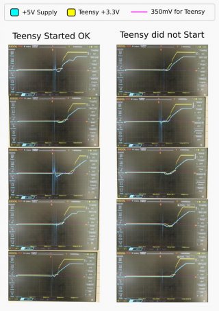

I recently noticed that my most recent Teensy 3.2 based project wasn't executing code occasionally, maybe 1 in every 20 power ups. I did some investigation and this is what I've found so far:
1. When the Teensy fails to execute code, 3.3V is still present and the teensy is drawing 20mA from my +5V supply compared to 40mA when the Teensy is executing code.
2. It seems more likely to happen during quick power on-off-on cycles, but also happens during a power on after a long duration of being off.
3. One of the things I tried was different value capacitors on my +5V supply and Teensy's 3.3V supply. All combinations, including no additional capacitors would still occasionally have the Teensy not executing code on power-up.
4. If a large value capacitor was placed on Teensy's 3.3V supply and left to slowly discharge after power off, powering on my +5V supply just as the +3.3V was at 350mV would almost always guarantee that the Teensy would not execute code!
I'm at a loss for this one, but #4 is pretty interesting.. so I can't help thinking there's some sort of weird condition happening during power-up that hangs the Teensy. Also of note:
5. The behavior is the same with the Teensy 3.1 that I also have, so it's not an issue with the Teensy itself.
6. It is also not code related, I uploaded the blink sketch for my tests.

Here's some scope shots of the +5V supply and the Teensy's 3.3V supply in the 30ms after power is applied. I was hoping to see some sort of pattern indicating why the Teensy occasionally decides to not execute code on power up, but I can't see any differences. I'll also add that I'm also able to get the Teensy to not start if I use my bench power supply for the +5V, these scope shots were with the L78L05 though.

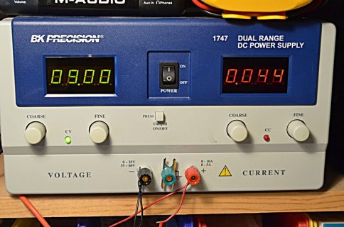

This is the power supply I used to the LM7805 input.
