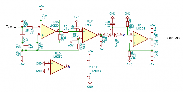

Alright I worked out the touch sense boards since I will have to redo them and make more so I can add more faders, it's quite interesting how they work and I know that the Digidesign Pro Control employs a similar method for detecting touch though it isn't all analog there.
Here is the resulting schematic minus any ESD protection on the Touch_In line:
Not all values have to be exact, but it's best to have a scope if you decide to change them to see what's happening.
If anyone wants to know how this works here goes, the first comparator starts by creating a square wave at about 60Khz:
When you introduce skin contact you create interference in this square wave, slowing it down:
From the output of the first comparator you have a simple high pass filter to filter out the 60Khz, here it is untouched:
Screen Shot 2020-06-18 at 7.25.10 AM.png Touched: Screen Shot 2020-06-18 at 7.25.34 AM.png
From that you compare it to a threshold voltage in the second comparator, that gives you a square wave only when it's touched:
When that square wave goes through the diode only the positive side conducts, the other side of the diode is weakly pulled down to ground with an added capacitor to further slow down voltage changes, the square wave thus becomes this:
All that's left for the last comparator to do is another threshold test and you get a nice smooth output of logic low when it's touched:

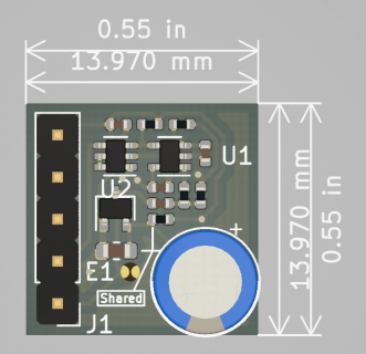

For my own sanity check I quickly made a board using the smallest SMD parts that JLPCB had in stock for their assembly service to see how small it could end up being and here's the result.
The three parts marked shared are common for all eight channels so they wouldn't be repeated for subsequent channels and they are there for ESD protection.
For more than one channel, as shown here, you could use dual or quad channel ICs and save even more space.
As for the motor control circuit I would ignore that part because it just uses PWM and it looks horrible, it works for preset recall but not for automation in any sense of the word.

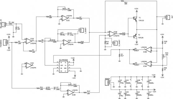

Hi , I am also working on my own motorfaders with analog PID but I am having some problems when trying to achieve both smooth slow travel and fast jumps. Fast jumps are easy but I just can't get slow smooth travel without increasing D way too much, affecting the fast jumps. Have you experienced this? I am using TKD MF-914 motorfaders with standard motors (not coreless) which I think have more friction than coreless motors. Do you know if your motorfaders have coreless motors or just standard motors? Thanks!
I am using this schematic I grabbed from the web:
hello. can anyone teach me how to do this kind of project from scratch? i dunno anything about this but my goal is to do a midi controller for my Ableton with about 50 knobs and faders, with the possibility of auto faders drop like in the video too, or even what you might advise to it more too please. i am very new into this hardware installation world.
It could be the H Bridges or your power supply isn’t suppling enough power to the motors.
