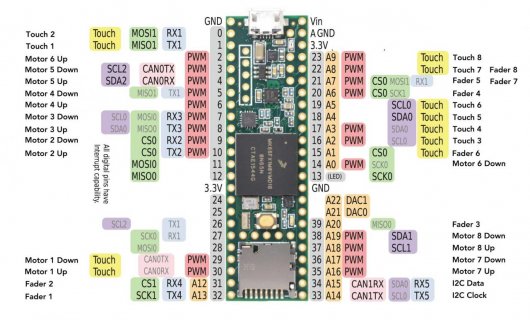

Using a Teensy 3.6 to control 8 ALPS motorfaders:
L293B H-bridges are used to drive the motors. The fader wipers and touchtracks are connected directly to the Teensy. Each faders has it's own PID control using 12 bit PWM at 14648.437 Hz. The ResponsiveAnalogRead library is used for the analog inputs, notice how stable the values are. Separate timers are used for the analogRead and touchRead:

A second Teensy is reading the values from the faders via I2C and shows the raw values on the LED displays using the LedDisplay library.
Fader panel bottom view:
The plan is to create a MIDI step & pattern sequencer with presets and this is an important first step. The code will of course be available when finished, in the meantime I'll be happy to provide snippets if somebody is interested.

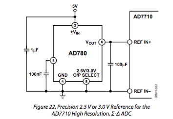

As an external voltage reference I used an AD780, this is definitely overkill but it was the only one I could find that would put out 3V, work with 5V and was through hole. The external reference may not be necessary but I thought it was better to be safe than sorry. The AD780 is connected as shown in the datasheet:

I never used external voltage reference before, you connect the AD780's Vout to Teensy AREF and to the + pin of the fader ?
Do you connect AGND to GND ?

Yes, the AD780 out is connected to the Teensy AREF and + pin of the fader. Remember to first set the reference to external in your code before connecting the external reference.
Yes, AGND is connected to GND

It looks to me like pin 22 and 23 are dual use but you do not specify any external logic to manage this. How can you connect 2 faders to the same pin or a touch and fader to one pin?
Maybe this is me being a teensy newbe, but how does software pin 64 and 65 map to physical pin 22 and 21?

Fader 7 and 8 in the diagram refer to the inner pins on the teensy next to the ones on the edge (22 and 21), these inner pins have number 65 and 64.
Kind regards,

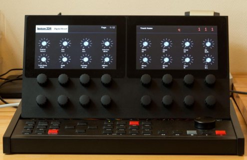

Here's a picture of the sequencer under construction:
The final version will have 16 steps (two panels), four channels and 16 patterns per channel.
