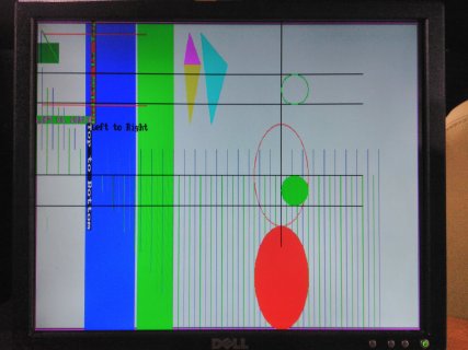

Here is the output produced by a teensy 3.6@240MHz in the highest resolution (800x600 with a framebuffer of 703x300), roughly 16KB of RAM remains free with this settings.

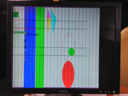

And here is the same using flexbus code (not yet on github), 4 wait-state, burst mode (reduce the number of times the address appears). The pixel clock goes faster, that's why the image is narrower. Black lines occur when address appears on the flexbus data line due to line multiplexing. Used flexbus pins are 21,20, 6,8,7, 37,65,35 (bit 0 => bit7 of the byte). Flexbus CSCR is set with a data path of 8 bits, BLS=1, AA=1. CSAR = 0x6000_0000, CSMR = 1. This is more or less similar to the LCD example of AN4393 (using FlexBus Interface for Kinetis Microcontroller)
