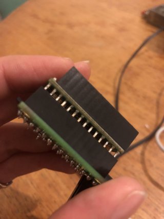

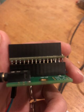

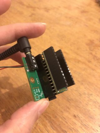

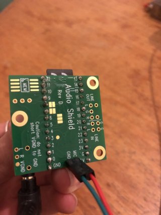

Hello folks,
for my wedding on 6th of september this year i want to build us this audio guestbook. I have the basic setup already up and running. Have a greeting and can record messages.

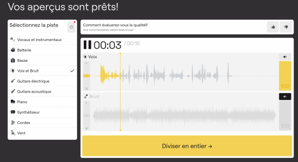

This is the audio quality i'm getting. I've tried replacing the original handset cable with a shielded one and i'm using the AOM5024 mic.
Is the often mentioned ticking noise which seems to be typical or is this another issue?

Hello everyone, I'm a bit late for the fight, but i'm also trying to figure out how to build and audiobook and I encountered some issues, so I thought it might be worth trying to post on this thread ! I've been looking a lot for my problem, but all the given solutions that I can follow doesn't work. I was a newbie when I started this, and all the encountered problems seem to have taught me a lot about arduino, so not so bad all thing considered.
No problem with the code or anything, but I encounter the damned "unable to access the sd card" issue. I've checked my soldering, not incredible but the multimeter reads signal in all 10, 11, 12 and 13 pins between my Teensy 4.0 and Audio Shield Rev D ; I've formatted two of my sd cards on both mac, then pc, then pc with a special program i found useful for others, but still getting the same issue. i'm out of idea now, if you have either a solution, or if you have a sketch that can test all the pins of the audio shield, that would be great ! Thanks A LOT in advance
Hey guys, I've the Click sound problem.
I post yesterday, and read all the 20 pages Here, try to disable MTP when Mic is running but nothing change
for a recap I'm running the project with
- teensy 4.0
- Shield Rev D
- Soldered Audio Break out (for the 3.5 jack)
- tested Few different mic
- tested with a MAX9814 amp mic
- tested with shield cable
Any solution to have a clean mic song when reccorded ?
Thanks
