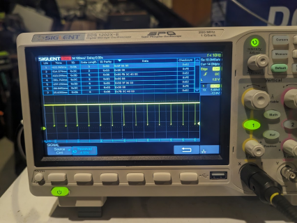

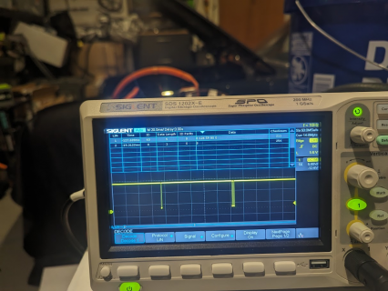

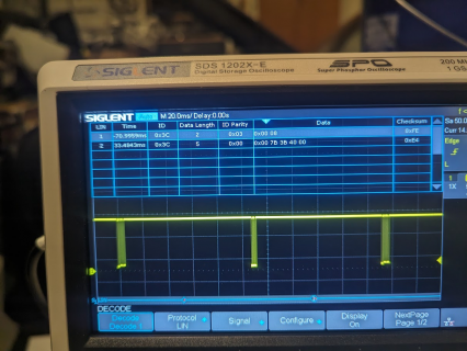

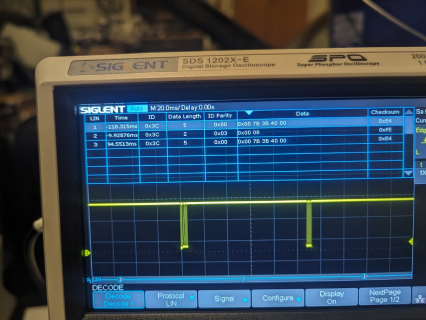

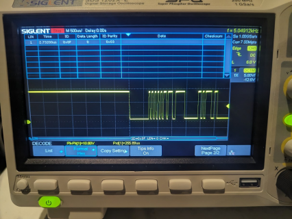

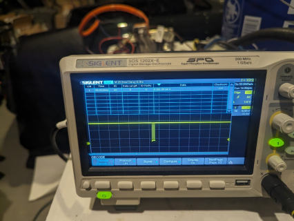

I am wondering about changing gears and focusing on the Status signal from ID 23(40) instead of 22(24).
I found a post from another site where the user was trying to get the HVH100 Webasto (Mine are the HVH50, 50 Plus and 70) running using PCAN-LIN and it talks about the ldf (lin description file) which is also mentioned in the PDF manual.
8.5 UDS-Diagnosis
The standard LIN 2.1 Diagnosis frames (see LDF file Frame
ID 0x3C / 0x3D) will be used to map Universal Diagnosis
Services / Sub-Services and Data.
The LDF file contents that were posted on this site looks like this (V1 used Lin 2.0 and V1.5 used Lin 2.1):

Something finally happened! On the Volvo heater, at 9600 baud, all FF all the time!!! At 19200, suddenly getting a 0 response at Hex 27 on every ID ordered, Every one (0 through 63). Strange readings on the scope.

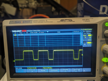

I'm not sure what to think about the scope pictures though. It looks like the scope is not able to decode the data correctly for whatever reason.
Paul

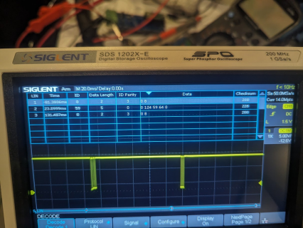

Here is the response withe new code you sent:

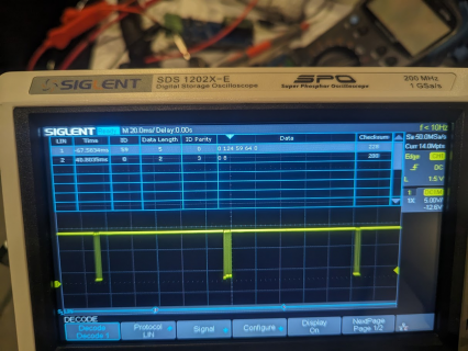

With Lin.Order commented out: I see variance in E3 E4 and D4 and 3C and 3B
Could you zoom-in on one of those bursts such that I can see the edges of the bits? I have a feeling that it is 9600 baud. Did you set the scope to 19200 baud when doing these measurements?
Paul

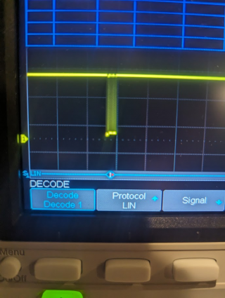

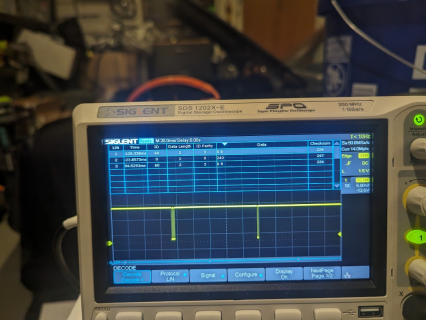

I reset the scope. Check out these readings. Hopefully more of what you were looking for:
OK.
Can you now zoom-in so that I can see the whole frame screen-wide? You have turn the time-base ["horizontal"] knob.
I think the data is not correctly decoded on the scope. You should never see ID 0x3C with my latest code.
Did you set the level in the Decode > Signal menu to around 6V?

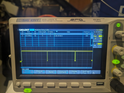

I have to turn horizontal to the left to get data to show up.
Can you turn the horizontal knob clockwise to zoom-in on one frame? Like I did in my screenshot above.
Can you also set the trigger to "trailing edge"? [it's called "Slope Falling" in the Trigger Setup menu]. And set the "trigger level" to around 6V?

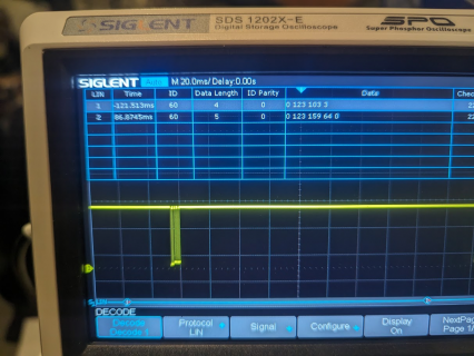

got the slope falling and zoomed in. Turned Trigger knob to increase to 6V.
Weird, I see ID 0X3D on your scope. Did you change this line in your code: uint8_t responseID = 0x27;.
BTW, you can zoom in by turning the horizontal knob clockwise and then you use the horizontal "position" knob to shift the image to the left.
Since we are taking any lin.response, isn't it possible that the 0x3C and 0x3D are giving us status messages?
Hmm, interesting. Although I'm under the impression that you need to issue a lin.response command to ID 0x3C/0x3D to get a message back?

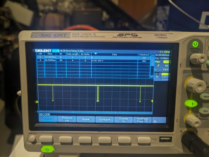

Did you also see a lin.response frame from ID 0x27? My code sends it every 100ms, so should be visible as well.
PS: I'm going off-the-air now for the rest of the night.
I am not sure about a response from 0x27 but will look. Thanks for the time and have a nice evening. I will play around some more, but glad there is some communication I suppose . . .
Here is one more frame I caught.
