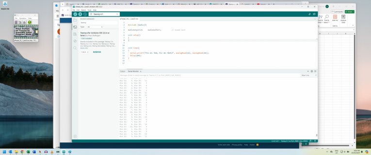

I've simplified it down to the most basic hardware and code. I've attached a picture of the hardware I'm using and a screenshot of the code and monitor window.

Given pin 22 is right in the middle of two I2S clocks (MCLK and BCLK) this just seems like noise, not any code issue.

Checked on a Teensy 4.1 here.
With AudioOutputI2S AudioOutPort; uncommented, it shows some noise.
With pins 22 & 38 connected to Teensy GND and to Teensy 3V3:
With AudioOutputI2S AudioOutPort; commented out, no noise is present:
Bottomline, AudioOutputI2S AudioOutPort; does not disable analogRead(22) but generates some on-chip noise.
Paul
PS: I tried pinMode(22, INPUT_DISABLE); and pinMode(38, INPUT_DISABLE); in setup(), but no change in behaviour.
With Teensyduino 1.59, setting the pinmode correctly is basically now built into analogRead() to avoid the old issue.
Thanks. The serial monitor displays pretty much confirm what I am seeing. Having established that Pin 22 is most likely receiving some on-chip noise, I've gone back to the original scenario I was debugging. The original case was a TMP36 3 pin temperature sensor chip, running from 3.3V, feeding it's output into Pin 22. (This is how the PCB has been laid out.) The analog value being read from pin 22 is around 210 (18C) without AudioOutputI2S, which is correct. Adding AudioOutputI2S changes the analog value to a range of random numbers between around 10 and 57, averaging around 35 (-40C). It is winter here but it's not that cold! It's hard to believe that on-chip noise could cause this, but I think I'll just have to accept that I should not have chosen an ADC input which is located between 2 high speed clocks.
