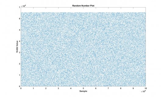

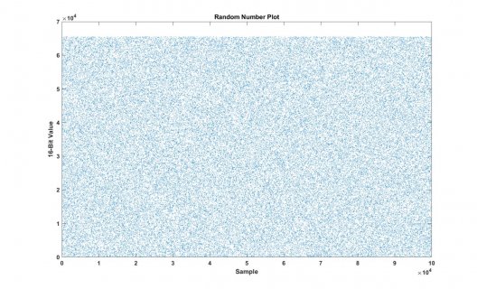

Running the Teensy4.1 TRNG exclusively with 0.1 million samples took ~90 minutes - too slow.
Using the TRNG as a random seed for the ISAAC PRNG is a decent cryptographic generator and very fast. 0.1 million samples ran in 0.028 seconds. I plotted the random numbers and its histogram. No discernible patterns can be seen. Histogram is flat as expected. See images:
An astronomical number of samples are required to detect bias. The ISAAC PRNG has not been broken since 2001 according to this article:
http://www.burtleburtle.net/bob/rand/isaacafa.html
