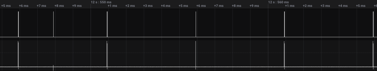

regarding the original thread, after some inspection of both analog and digital channels in my logic analyzer, it seems likely that this was noise in the digital measurements. Very anticlimactic

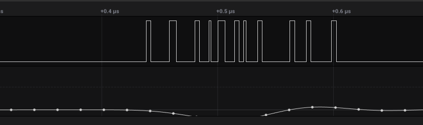

At least I think that's the case, hard to say whether the logic analyzer is wrong when I base my "correct-ness" on the logic analyzer output :)
I'm not sure before/after would show much, my cable length isn't extreme anyway. The main debugging came from gathering analog simultaneously and inspecting the false rising edges. They showed nothing in the analog view even with relatively high sampling time.
@defragster I just tried your script from #23 and I'm not seeing the same bounce, at least for this short time period:

To be honest, not sure if it's actually fixed, I'm still seeing some occasional rippling on the digital output from the teensy. I'm not 100% convinced it's the logic analyzer, this ripple is happening here in the middle
where the widest HIGH is 6ns. Logic analyzer is set to 3.3V logic level w/ 500MS/s digital and 50Ms/s analog sampling rates. I'm basically maxing out the sampling rates so I can't really get any more precise on the analog side. But I'm having a hard time understanding whats going on here.
Note this is with pin 2 as the signal, and I set pin 1 as LOW in the setup, so grounding is spatially close to signal, and the cables are pretty short.
