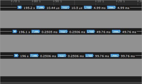

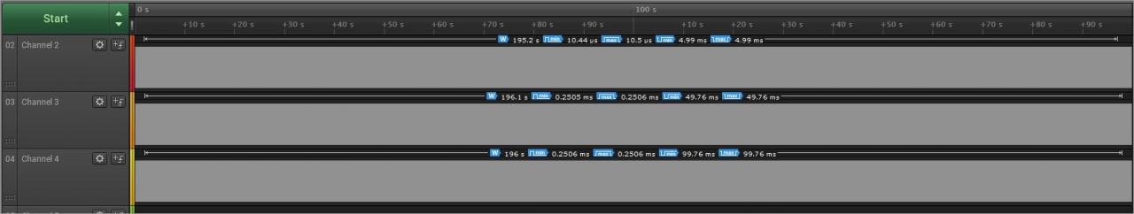

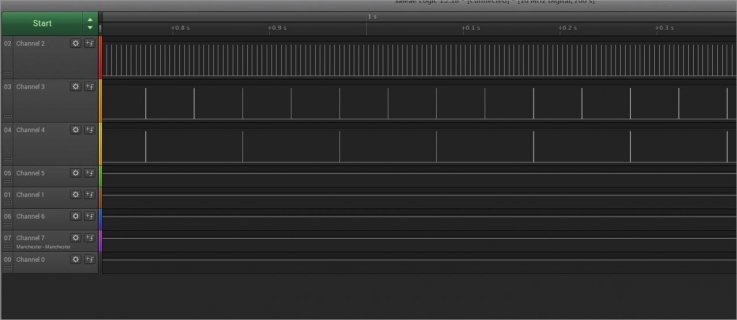

Overall this has been working fine but I am experiencing some unexpected deviation in the rising edges. I'm using a saleae logic pro 8 as oscilloscope and clock the following results after collecting data for 10 mins
I'm still analyzing but I think it seems pretty clear that the increase in std_dev comes from the standout f_max.
- run 1
- 200 Hz => [f_max, f_mean, std_dev] = [200.006, 200.001 Hz, 66.801 ns]
- 20 Hz => [f_max, f_mean, std_dev] = [20, 20.0 Hz, 69.55 ns]
- 10 Hz => [f_max, f_mean, std_dev] = [10, 10.0 Hz, 80.643 ns]
- run 2

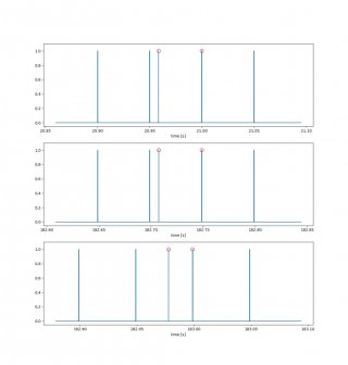

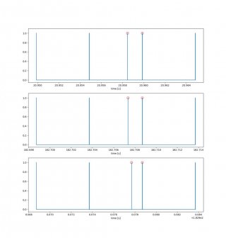

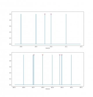

- 200 Hz => [f_max, f_mean, std_dev] = [990.805, 200.006 Hz, 19.808 us]
- 20 Hz => [f_max, f_mean, std_dev] = [116.118, 20.005 Hz, 635.732 us]
- 10 Hz => [f_max, f_mean, std_dev] = [115.529, 10.005 Hz, 1.836 ms]
