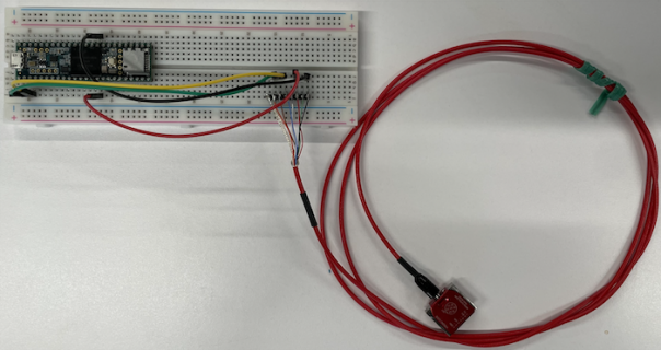

Hello, I am working on building a data acquisition system for 5x FUTEK LSB206 Load cells with UART output using a Teensy 4.1. The load cells use QIA128 controller chips to interface with a host system via UART, which is more thoroughly documented here. The load cells offer a "Stream" Mode, which, upon initialization, causes the device to send 4 byte packets containing ADC readings to the host over UART. The structure of the packets are:
<Highest Significance Byte> <Middle Significance Byte> <Lowest Significance Byte> <Checksum>
Where the checksum is calculated:
 Checksum = (HSB * 1) + (MSB * 2) + (LSB * 3)
For my initial prototyping I am just using a single load cell.
To the Teensy 4.1, I have attached the load cell's Vin to 3.3V, Gnd to Gnd, and Rx and Tx to Tx1 and Rx1.
I am using Teensyduino and the Arduino IDE. I have written a basic class to send/read commands to/from the load cell using Serial1, which I have used successfully to collect adc data from the single load cell in stream mode.
Given that I will be using 5x of these load cells eventually, I want to use DMA to have the packets being received by the teensy be automatically read into a ping-pong buffer so that it can be saved to a file on an sd card via an interrupt at the end of each half of the buffer.
The full source code is attached to this post, but below is the main script.
