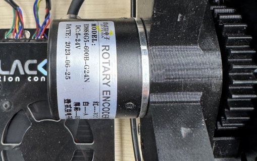

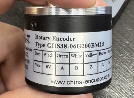

Yes, I do have them with INPUT_PULLUP. Unfortunately the encoder I have is locked down with another project but I believe it is that same one you have there so I expect I would get a similar output. I've uploaded a picture of the encoder and it seems to be the same one. Here is also a link I found with the specs. It looks to be 600 ppr (encoder).
I do see what you're saying regarding the direction that would work, I could check just for if it's negative or positive to keep drag of the direction.
My question would be since I am wanting to get the time of the pulse. Before I tried doing it by adding the following code to the isr for the pin being used:

Do you think this works as I intend or would there be a better way to go about it. And by any chance do you happen to know if there is a way to read the pin directly in the Teensy 4.1 like you do port manipulation in arduinos?
Also are you driving that encoder with 5V or just with the 3.3V from the Teensy. I ask because I was told they needed to be 5V and to use a level shifter. Which works fine when using it with the Encoder library but for some reason when I use the level shifter with the QuadEncoder library it doesn't work at all and gives me values that are all over the place.
You don't need to use a levelshifter since the output stage of the encoder you referenced above has "NPN open collector output circuit". See this thread for more info. So just power it by 5V.

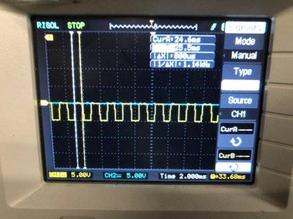

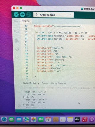

So we tested with an oscilloscope and got some time recordings for the high and low pulse and determined that for some reason the FreqMeasureMulti library wasn't giving us the right values but we've tested a code that seems to be working whose recordings match what we're getting on the oscilloscope.
This is our current code:
The FlexPWM timer used by FreqMeasureMulti requires very fast edges. Your signal looks like it has rather slow rise/fall times, and that will not work with FreqMeasureMulti. Can you add a schmitt trigger on your input?
Understood, I believe the encoder I was using for that test was a bit lower in resolution to what I am using now. Would a higher resolution encoder work better to use the library? At the moment I don't believe I have one around.
Quick questions
Yes, 5V from Teensy Vin pin to the encoder 5V VCC. And no, no external pullups to 3V3 - just use pinMode(5, INPUT_PULLUP); to enable Teensy's internal pullup.
Also further question on this, It appears we are using a different encoder now which according to the model information I found seems to have a line driver output instead of an npn as you mentioned in that thread. I assume this would prevent me from using it with just INPUT_PULLUP or can I still do this?
From what I read on that page, the 200PPR GHS38-06G200BML5 apparently has an "RS422 (line driver)" interface. Since RS422 specifies differential signalling, I assume that A+/A- and B+/B- are the connections that we should use?
Still I would like to see a real datasheet to be certain what voltage levels, timing and pin connections are to be expected.
Paul
PS: found this on AliBaba:
I think the whole reference to RS422 is not relevant? I guess it just has a differential output driver.
Follow-up: based on that last picture of the "L" differential output stage, it is highly possible that the output signal level will be close to VCC, in your case 5V. This 5V level will kill your Teensy so don't try that. Best is to check the output signal levels with an oscilloscope first to make sure.
As a side note: the "E" open collector output version apparently has a built-in pullup resistor to VCC. Again, if the VCC is 5V, that output pin will lifted to 5V which is lethal for your Teensy.
All said, it's probably better to look for a different rotary encoder that has clear documentation.
Paul
