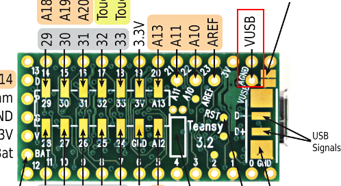

Anyway, so I thought it would be possible to connect to the USB contacts on bottom of the board:
So I bought some of these:
And did this:
As you can see from the image, the power LED is not on. I measure 5V on the board contacts.
Seems like a dead board :(
Is there something else I can do to check/revive the board? I'd like to at least have a way to clone the program, so I can copy to new hardware.

That connection looks like it ought to work. But the photo is blurry, and shot from the Teensy top side so we can't see how the wires are actually soldered. If you can share a better photo, and if it's a "simple" problem with the connection hopefully we'll be able to see.

In Device Manager I am seeing this:
It seemed like it maybe a motherboard driver issue - updating the drivers didn't help.
I tried on 2 other Win11 PC's and saw the same thing.
Data signals were connected correctly. Not my proudest moment for soldering, but the continuity between board connections seems okay with a multimeter :)
Realizing that VUSB was supposed to be connected to the pin highlighted below and not the pad, I removed the red wire from the pad to the pin hole for VUSB. This didn't change anything, but I guess that they are internally connected anyway.
See the pictures above + the latest soldering of the VUSB connection below from both sides :

You may want to inspect your Teensy carefully as well.
Are there perhaps shorts in the red circles?
Paul
Where does the bottom D+ get routed to on the Teensy? It looks like the entire pad on the top got ripped off, so if the bottom pad goes through a via to the front of it, it won't be connecting to anything.
Yes but how does the bottom D+ pad get routed there... This is specifically the via I'm focusing on since the pad marked in blue has been ripped from OP's board:
Windows at least recognises something. Please swap the D+ & D- (the orange & wire) and try again. You won't hurt your PC or Teensy.
Yeah, I did notice that and I completely agree - it doesn't look good.

I checked the datasheet linked by PaulStoffregen - thanks, in it I found that one of the pins (6) seems to be related to USB :
Thanks, I am also interested in this. Is there a way to bypass the broken pad/tracks?

Ah, yes, this is the older Teensy 3.2 PCB where the D+ pad connects that that via to the USB connector pad, and then does underneath those 2 capacitors to reach the 33 ohm resistor.
Newer Teensy 3.2 had a different layout. Not relevant here, but mentioning because other people might later find this thread. This doesn't apply to all Teensy 3.2 boards.
For your damaged board, soldering D+ to the bottom side pad won't work because the connecting from that pad to the resistor has been destroyed on the top side. Your only hope is to solder to the tiny resistor.

Update:
Linked directly from D+ to R2 as you recommended and that did the trick. The board is working as expected again. 🥳
