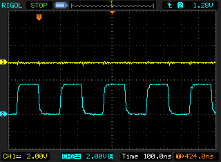

Here's the the SS and SCK waveforms while running this code:
  digitalWrite(CS, LOW);
  SPI.transfer(sample);
  digitalWrite(CS, HIGH);
Notice the dead times between each byte? A frequency counter that measures the number of pulses over 1 second or 0.1 seconds will count fewer than 4 million (if the software keeps repeating SPI.transfer) because of these idle times.
If you use the 'scope to view the waveform, it's easy to see the SCK frequency really is 4 MHz (2.5 divisions at 100 ns per division).
The idles times between transfers also happen on AVR. With the Arduino SPI library, which was designed around AVR's simple SPI port, these idle times are unavoidable.
