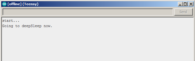

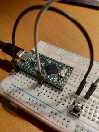

I'm having issues waking my teensy LC using the sleep_all_wakeups. I commented out all but the digital wakeups and added a serial output at the start of setup to make sure that the current code is running on the board. I manually connect pin 21 or 22 to the 3.3v pin. When I boot it, I manually unplug and replug that wire in order to create the rising edge. No luck. I have no idea what to do from here.
