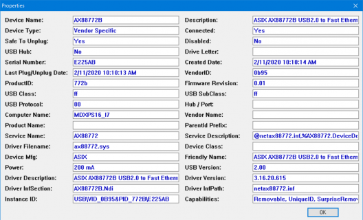

Hopefully there is a simple fix? I got two of the same from Amazon - USBDeview:
Amazon 'Basics' USB 2.0 version
And another exe - USBView.exe:

It still works for me. Amazon USB ether dongle hooked to T4B2 USB host port. Ethernet hooked to switch -> router/switch
dongle's yellow and green LED are ON. Built/ran example ASIXEthernet_Test sketch which says:

if i plug dongle into linux, lsusb says: Bus 001 Device 004: ID 0b95:772b ASIX Electronics Corp. AX88772B

Wondering if you got the USB2 or USB3? As linked above the 'Basics' version USB 2.0 has 'black' insert block in the USB connector - as pictured on the U.S. Amazon site. I ordered two at different times - and both arrived with the same compatible chipset on them. I wanted an extra for my Surface laptop with no built in Ethernet and it worked well there too.
so close … not choice but indeed 'basics' > https://www.amazon.de/dp/B00M77HLII
Ok, the Amazon Basics USB2.0 adapter works.
