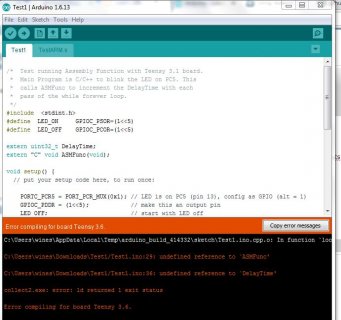

I am working with Teensy 3.6 and trying to run the crypto library. The crypto library has assembly functions that need to called from the IDE. That's exactly what this post is about. Hence I tired to run your test1.ino in teensy 3.6 with arudino ide 1.6.13 and it gives the following error
C:\Users\wines\Downloads\Test1/Test1.ino:29: undefined reference to `ASMFunc'
C:\Users\wines\Downloads\Test1/Test1.ino:36: undefined reference to `DelayTime'
Error compiling for board Teensy 3.6.
Any suggestions on what I am doing wrong would be greatly helpful.
Thanks

It looks like Arduino builder doesn't handle the '*.s' assembly files. Rename them to '*.S'.
