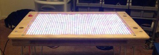

Quick Update: I am using a 60A power supply with this setup. It's a kids table with 6 panels of 16x16 leds in a 32x48 configuration. It has 1536 leds. It's pretty awesome, but as Paul says current and heat can quickly become an issue.

Automata ftw! Nice setup indeed. How long do you have this running at a time and how warm/hot does it get? Also where did you get your power supply? Would you recommend it?

The power supply I used is very similar to these on alibaba. I am planning to have these for sale very soon at www.rgb-123.com. They work really well. You have three circuits of 20A to get the full 60A output.
If you run the leds at full brightness the pcbs get pretty warm/hot. Production boards will have a min of 2 oz copper, right now these are for prototyping at 1 oz copper. Really though running the display beyond a brightness of 128 counts and more practically 64 counts. For the kids table I typically run them at 32 counts since the kids are pretty close to the lights. It really can't be underestimated how stinking bright these leds are.

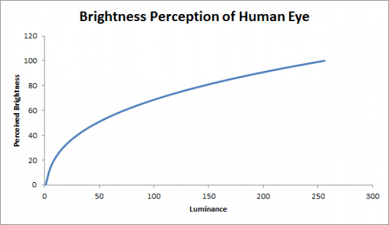

Based on this curve there is a diminishing return in the light perceived by your eye beyond 125ish counts. I did a pretty big writeup at www.ohararp.com/blog on the light/color output of these leds.
