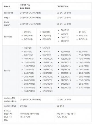

I want to control some light dimmers with a teensy.
I'm looking at this:
https://www.aliexpress.com/item/32975095882.html
however, in the list of Arduino's, it lists some of them as only having one pin suitable for the input (zero cross). I'm not sure why there is this limitation. I assume the teensy (4.0 or 4.1) will have a suitable pin(s)?
thanks
Just found some more info, but it still doesn't answer my question. Perhaps someone else will understand more than I do?
Dimmer is connected to Arduino controllers via two digital pins. First (Zero) to control the passing of Phase Null of AC, which is used to initiate the interrupt signal. Second (DIM/PSM) to control (dim) current.
Note that Zero requires connection to designated microcontroller pins (which are different depending on the model of Uno, Nano, Leonardo, Mega), since it tied to microcontroller interrupts.
And now I've realised that this is not a trailing edge dimmer, so its not suitable. I'm still interested as to why there was this pin limitation, and how it applies to teensies though...

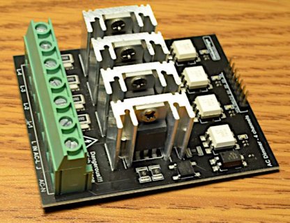

My worry is that unit may be completely uncertified for mains use. They don't show the underneath of the PCB to allow assessment of
the clearance and creepages across the opto-isolators. The triacs are not isolated-tab packages so the heatsinks are all live, that alone is worrying.

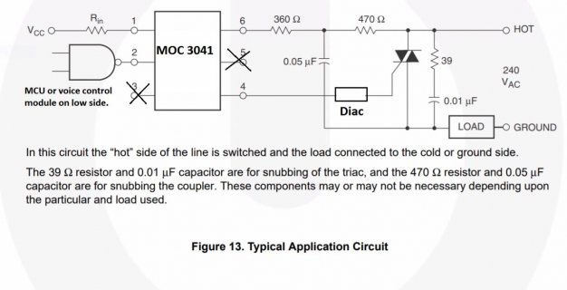

The reason there is even a zero crossing pin in the first place is the optocouplers they use are CHEAP and do not have zero crossing detection. this is a tactic to get rig of old outdated stock and save money. the MOC3041, 42. and 43 has zero crossing built in thus negating the need for a Z-C pin. the original can be desoldered and the new MOC series can be resoldered thus no need for zero pin. this then can easily be controlled with PWM of any controller.
you can they modify the original program negating the ZC pin all together simplifying the program.
My suggestion is do not buy it unless it has zero cross built in or like i said modify it to work right. also another note is the Triac could have zero cross built in which these do not.
PS. i am working on a PWM voice activated control module using such a circuit.

Just so people know PWM can NOT be used on zero cross Triacs. this would take a random Triac which can be had for cheap. the BT139-800E is 800 Volt 16 amp for only a $1.01 at mouser. They are sensitive gate "series E" triac's intended to be interfaced directly to microcontrollers, logic integrated circuits and other low power gate trigger circuits. for better triggering use a Diac though. just FYI.
