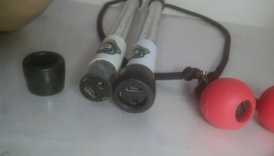

Touch-pad :: T3.6's USB port accessible at the end of the poi, and a DC-plug for battery recharging.

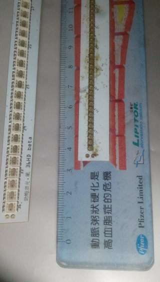

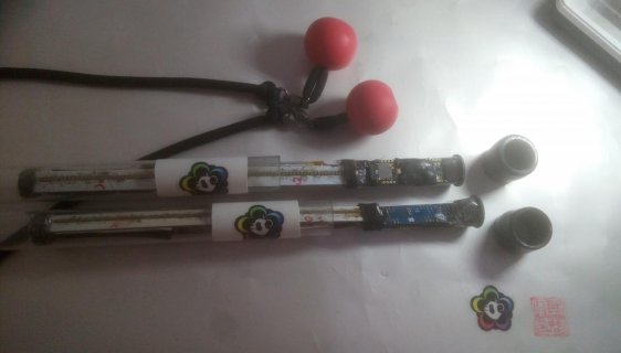

->3 parts of PCB : ( the core holder, the touch pad, the LED stick*2)
->the touch-sense pad act as a control button (like a momentary button with no spring -feedback) that debounces, and can tells apart-single click, double-clicks, multi-clicks and long-press.
->Apa102 – 2020 - 80 (24-bit RGB) pixels in 20cm, I had some very hard time soldering with those evil devils.

the T3.6 's Mk66 chip is buried in black hot-glue, the SD-slot and program button is visible outside.
It is a hard and sticky kind of glue, and shock-protection is needed for the BGA chip,
not sure how much extra protection is given, but I haven't had a board with black-glue damaged,
In compare I had 2xT3.6s shown poor contact after some shock. I had no skills to repair them so had to replece them.
