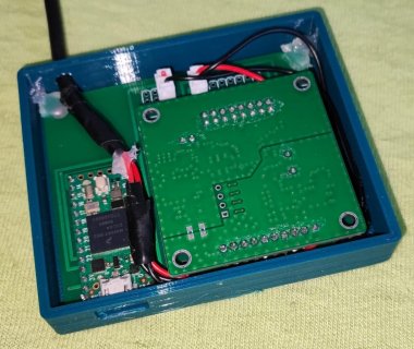

I have Teensy 4.0 and project where I send data via USB cable to PC. But quite offten I hav problem, if I touch the cable or Teensy in plastic box, then Teensy is starting connecting and disconnecting and I have to move with micro usb connector many times to connect again. Do you have eny experience how to solve it? Maybe use any external usb connector?
I need very durable connector solution beacuse I use my project in field mesurements and speed of USB in the same time.
For you information, this is the box:
Thank you!
Sounds to me that the USB cable is not inserted all the way into the Teensy 4 USB connector. Is the opening in the plastic housing large enough to let the cable through? Can you show us a close-up photo of the Teensy USB connector with the USB cable plugged in?

Yes, connector is all inserted (tried without box). Seems loose a lot. Tried many cables. I can move the connector left/right very easily and Teensy is connecting / disconnecting. Is there any way how to correct it?
USB connector pushed in many times and probably not carefully. That is probably the source of your bad connections.
Probably about time to change the connector to a chassis mount one as has been described to you.
Otherwise the Teensy may well stop connecting to the PC with that worn Socket.
