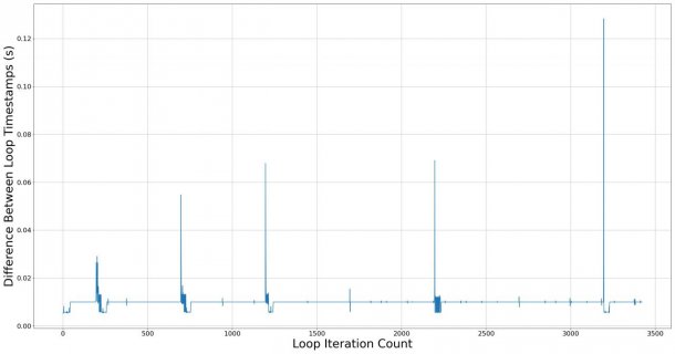

I have a T4.1 and I'm trying to do ~100Hz data logging to an SD card via the built-in slot. Even when running the T4.1 overclocked, I have inconsistent logging rates. Most of the logging is at 100Hz, but sometimes I get lags of up to 0.125 seconds! These lags are not evenly spaced through time. Even more odd, I also sometimes have a log rate of over 100Hz (not sure how that's even possible due to how I have my code setup).
The big question is: what is causing these timing issues (especially the lags) and what can I do to mitigate them? I understand that writing to a larger buffer (i.e. 512 bytes or so) might help, but I'm not writing much data per loop and 100Hz isn't that high of a sample rate. I don't think the SD interface should be struggling so much at 100Hz (IMO).
Below is my code:
Also, here is the plot showing loop latency:
