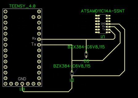

I have the following:
- Teensy40 using LPUART8(pins 20/tx and 21/rx) to communicate with atsamd11c14a on pins 9 (tx1) and 10 (rx1). There are 2 ESD diodes on each line to ground (BZX384-6V8).
The link is done as follows:
Pin Teensy/20/tx connects to SAMD11C14A/10/Rx1
Pin Teensy/21/rx connects to SAMD11C14A/9/Tx1
Why I ask for help:
- if I connect the atsamd11c14a to a usb-to-serial to the PC and send the command that I need, the atsamd11c14a responds with what I want.
- if I connect teensy40 on the usb-to-serial to the PC and sniff the USB communication with Wireshark/USBPcap I can see the request command sent by teesny40 being the same with what I send when I test the previous point.
- when I connect both and try to send from teensy to atsamd11c14a then I get no reaction. atsamd11c14a is not providing the response I expect and observe when I test with the PC connection.
BaudRate config is 460800 on both.
Circuit is:
Could be that the problem is with atsamd11c14a. I will find a forum there and ask the same. Could be that the baudrate is not the same even if by the looks, they have the same number.
